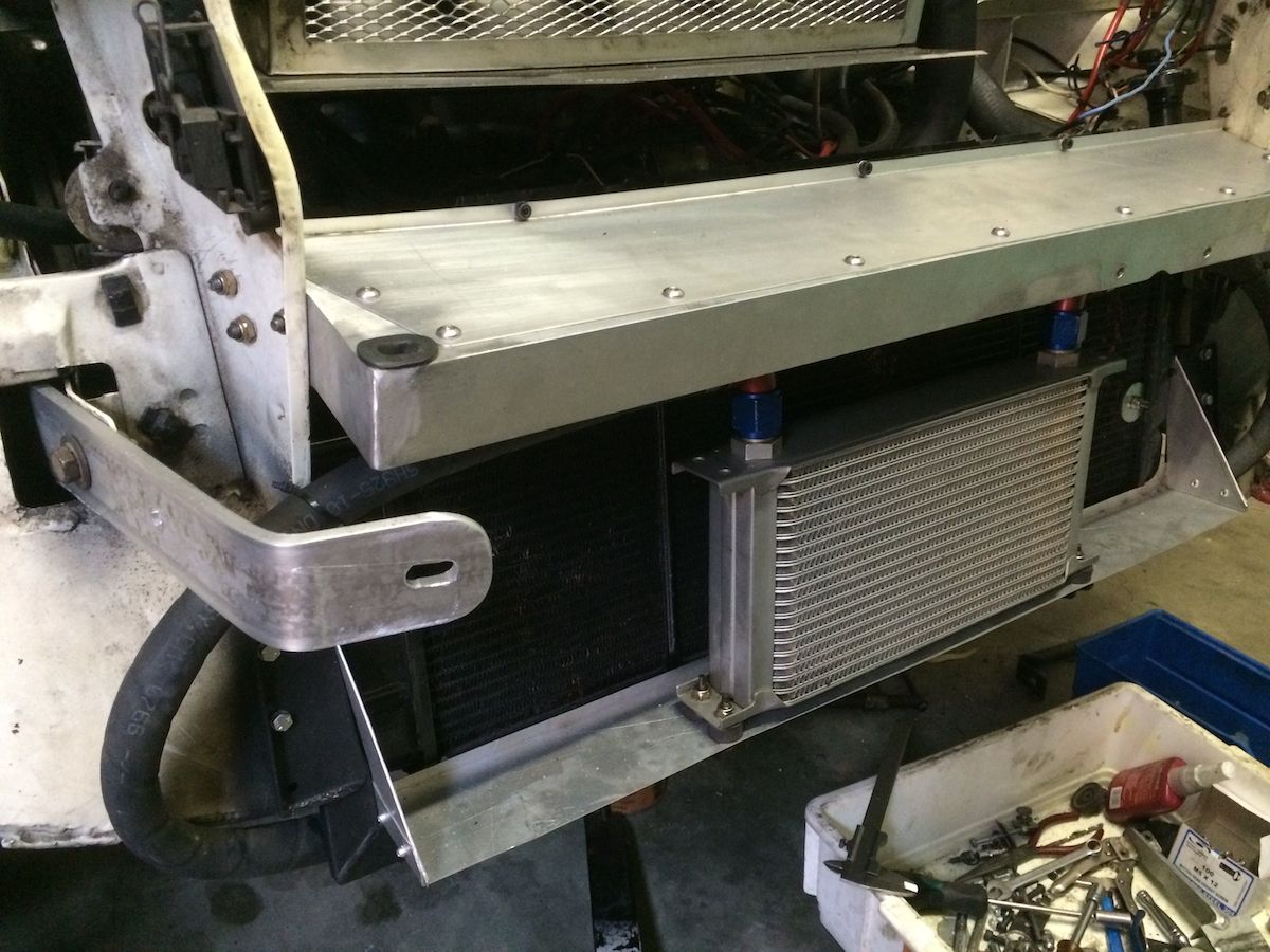

Yep, force everything through the radiator. I have a piece of aluminium angle, which doubles as a support for the grille, in true Colin Chapman style. The sheet of thin aluminium has a 90 return, which bolts to the radiator.

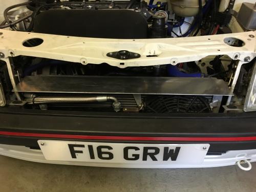

woodymi16
Alloy sheet on mine
Simes
Alloy sheet on mine
I like how you've done this, nice finishing - mine is similar but more of a lash up!
We've even even had similar ideas on how to hold the grill in!
Where do your mounting points for the lower grill attach to?
9018928474_4225faab50.jpgIMG_0362_1280x956 by Simon, on Flickr
