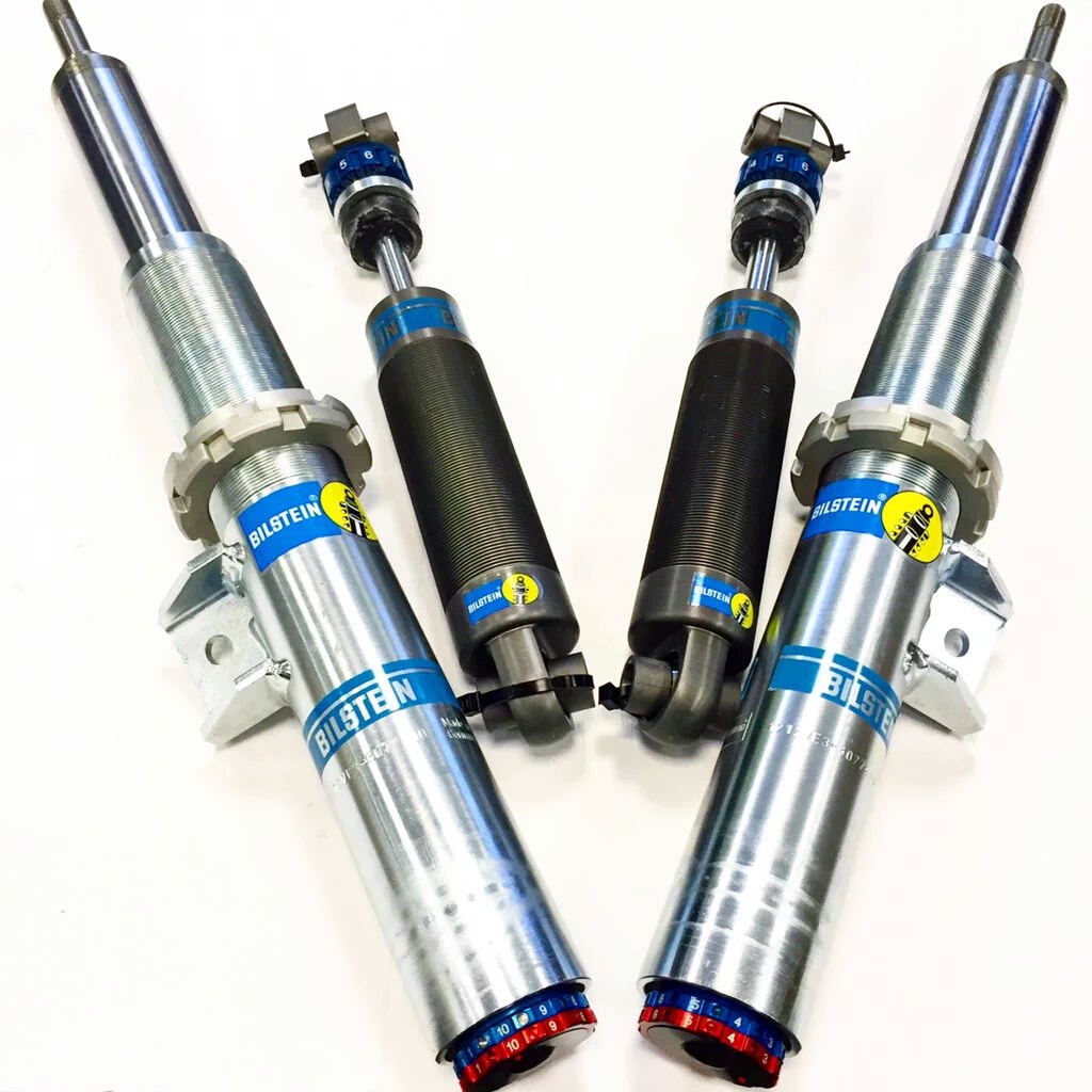

welshpug 1,737 Posted February 21, 2016 (edited) I saw a picture of some 205 2 way adjustable bilsteins last week. Edited February 21, 2016 by welshpug Share this post Link to post Share on other sites
And 15 1 Cars Posted February 21, 2016 Oh sound good, I may wait then in no rush stared to look last year miles then a expensive engine rebuild and then a box upgrade to make matters worse seen all the funds drained away and also having to fund a stilo intercom seen PLR never sent the peltor one I payed for but won't go into that.. A few week or month will help Have you got that photo Mei Share this post Link to post Share on other sites
welshpug 1,737 Posted February 21, 2016 correction, not 3 ways only two way adjustable, for a circuit car so didn't need the extra oil capacity a rally damper needs. ask bilstein uk if they can do something. Share this post Link to post Share on other sites

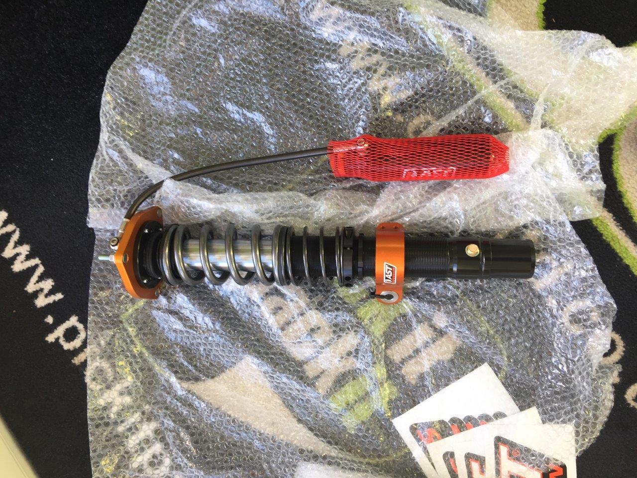

woodymi16 24 2 Cars Posted February 25, 2016 I ordered a set of 3 way adjustable from AST on the 25 November and they where delivered today! Share this post Link to post Share on other sites

Batfink 201 Posted February 25, 2016 Didnt take too long then to arrive lol Share this post Link to post Share on other sites

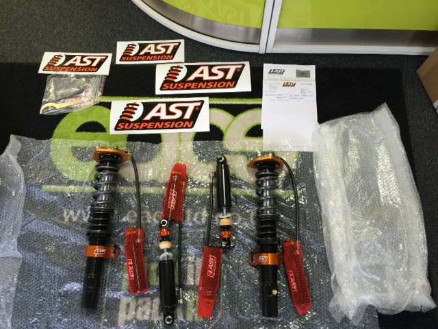

And 15 1 Cars Posted February 25, 2016 You seem to be 3 dampers short graham lol, let me know how you get on with them knowing the lengths of them would be good too if poss please. Share this post Link to post Share on other sites
woodymi16 24 2 Cars Posted February 26, 2016 At least the lead time gave me a chance to save up the money to pay for them. Just to prove I have all four! Share this post Link to post Share on other sites
woodymi16 24 2 Cars Posted February 26, 2016 You seem to be 3 dampers short graham lol, let me know how you get on with them knowing the lengths of them would be good too if poss please. I'm home next week so I'll send you the spec I ordered and the dimensions. Share this post Link to post Share on other sites

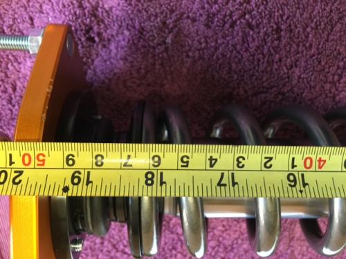

And 15 1 Cars Posted February 26, 2016 Curtis did say the rears were 340mm bolt centre to centre but looking at that there it don't look to have much travel maybe you can confirm, mine cocks a rear wheel up easy so some drupe would be nice if poss too. Share this post Link to post Share on other sites

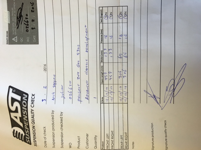

woodymi16 24 2 Cars Posted March 5, 2016 I'm home next week so I'll send you the spec I ordered and the dimensions.Not sure what you need but here is some info. If you want any more let me know. Share this post Link to post Share on other sites
And 15 1 Cars Posted March 5, 2016 Interesting he quoted me a longer rear maybe afew options when they assemble them, altho I have found on a ast leaflet 6300 rally series ones that are not on the web site so I wonder if it's them he originally quoted for me. Share this post Link to post Share on other sites
