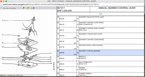

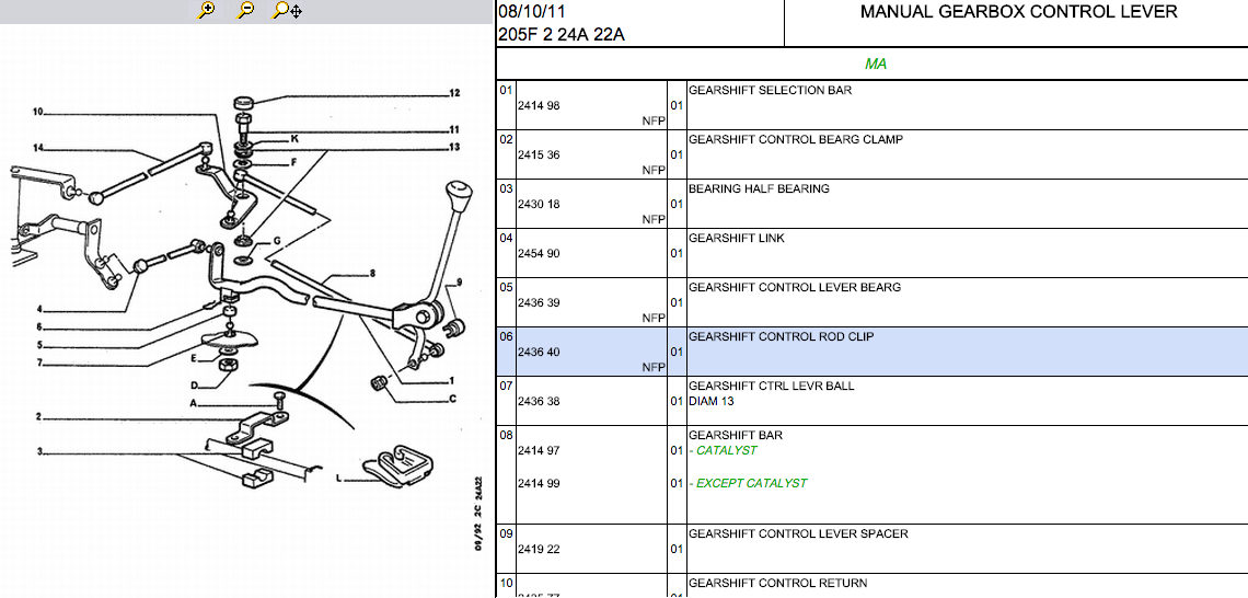

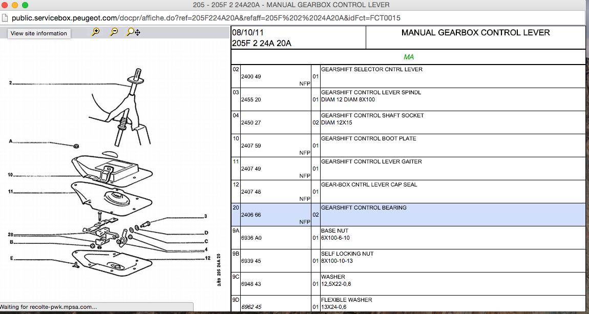

The gear linkage looks like a GTI one, but on Servicebox its looks a bit different for MA boxes.
I'll give it a go and see if it fits.

Which one is that on the picture above?
its not specifically on those diagrams, but is pictured, its the arm with two ball joints that link rod #4 is connected to
