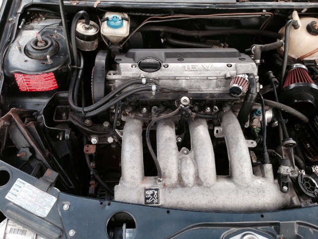

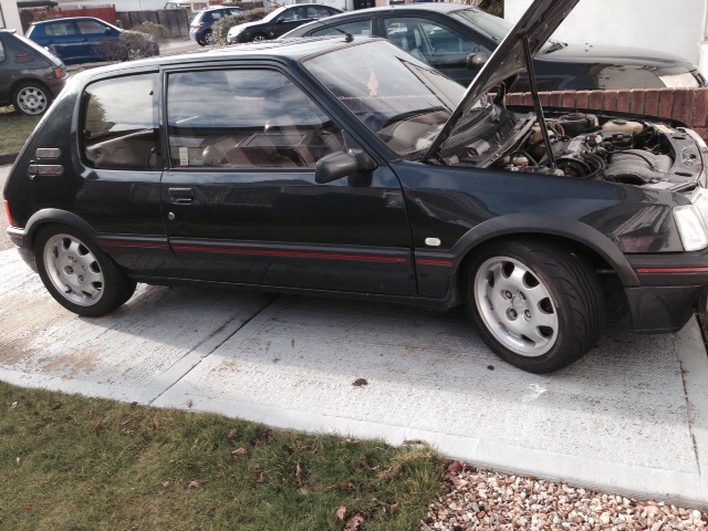

Acquired a new project off a fellow member so thought it was time to make a start on some of the required work.
Firstly brought the car knowing of a few issues that I was aware of a few I've since picked up on and I'm sure some that will come to light but that's the joys of these cars is it not?
What I know, suspect and plan to do

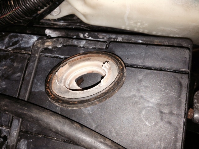

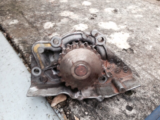

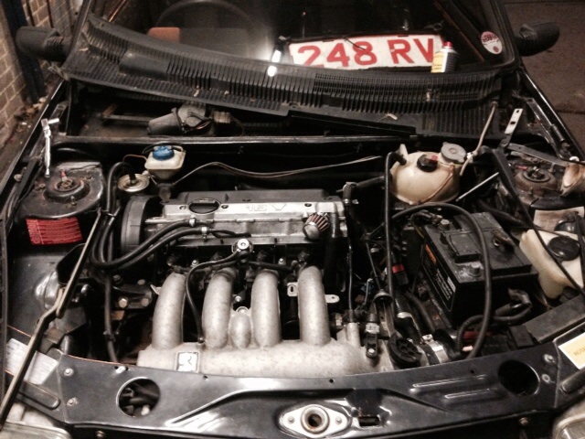

Waterpumps leaking, I'm in progress of changing that now so I can then assess the suspected headgasket failure.

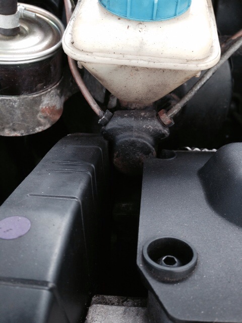

The master cylinder needs "adjustment" it's currently that close it looks as if the cambelt cover is permanently rubbing camshaft pulley/belt. I have a spare be3 pedal box that I've opened up servo bolt holes to move it up and space it a bit. Not keen on cutting cambelt cover so I'll shave some off the master cylinder as well. Hopefully that'll give enough clearance. Any other suggestions how this can be archived?

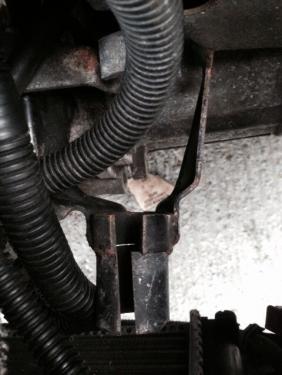

Looks as the vts engine and box was fitted as one with the original pull type clutch, not an issue but the gearbox mounting bracket looks as though it's hard up against the clutch cable bracket. Considering fitting the spare 306 mount with a bit of work that should leave some space.
The clutch cable runs round the front of the engine so I'll be looking at that.
It has a twin fan set up wired on a switch so ill use the original diesel fan wiring I have.
Tap thermostat housing and fit "bunged" up pipe.
Find and fit phase 2 expansion tank, 306 battery and ecu box just out of preference really.
Bonnet hinge broken on n/s a job for a bit later along with the front wings, o/s is rusting and both have been replaced at some point and side repeaters fitted in wrong place.
I'd be interested if anyone else knows anything else about the car?

I don't think you'll have much choice but to cut the cam cover. Mine would never have gone together without cutting it, not in a million years. I had a pedal box shaped wedge made up to tip the pedal box upwards while still maintaining a decent seal all round. Worked well.
Photo below is the MK1. Never took a photo of the MK2 but it's similar.

Where did you get that wedge made and how much? I managed to get a fair bit of clearance on my other 205 did need to shave some of master cylinder though.

Also looks like the clutch cable bracket has been modified to accommodate the standard 205 cable.

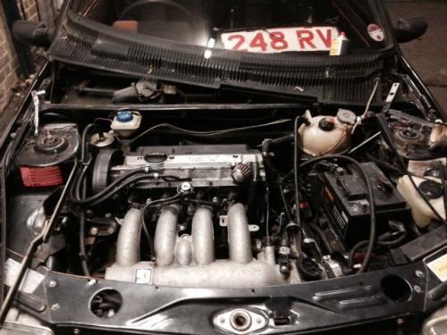

Well a little bit of progress moved up and spaced the servo which has allowed a wafer thin gap next to cambelt still plan on shaving some off the master cylinder before last resort and tampering with the cambelt cover.
Re routed the clutch cable to run round the back of the engine.
Fitted the twin fan set up and wiring to do a way with the manual switch fitted inside.
Was a little sluggish to start but ran for a bit whilst I was trying to bleed the air out the cooling system, reconnect the lambda sensor that had been disconnected reason unknown ATM.
Car cut out and didn't want to start, battery is definitely low on juice I'm certain I have a charging issue as I don't recall seeing a battery light at all.
Next to stick a bit fuel in pretty sure that's why it cut out :/ then get probing with the multimeter.
