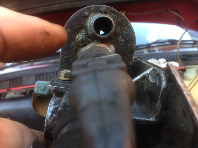

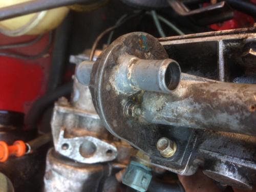

Is that the nut that makes the hole bigger or smaller? When I undone the screw nothing seemed to happen.
There is the hole in the SAD, I stuck a screwdriver in and it seemed to spin around.
Stupidly I unplugged all of the HT leads from the dizzy and couldnt remember where they went, found some pics so I now know where they go.
Is the SAD working from what IV described and from the pics?

If its open when the engine is cold and closes when the engine is hot its working beyond telling you that there is nothing anyone can tell from a pic.

The SAD is open sufficiently in that picture for cold running - worse case it doesn't close would cause a high warm idle, not the issues you're seeing.

The hole looks as though it's as small as possible. Undo the little nutting then the bolt should move from side to side slightly. It may help if you pass a screwdriver through the hole of the disc in the valve so you can push the disc and make the hole bigger. Do it gently and make the hole a bit bigger, hold it as it is with the screwdriver and then tighten the nut.
Mine had a cold starting misfire and this was my issue. After much hunting for a cause and solution Tom (on here) pointed me towards this and after a quick adjustment it started perfectly. It also turned out that my AFM was buggered though but that has more obvious symptoms that I was also getting.
There's no default adjustment setting for the SAD, it'll vary from engine to engine. Try the adjustment, then start and let the car warm up so you can do the usual setup for idling with the throttle position, idle screw etc. Then let it cool and try starting from cold to see if it's been successful.
