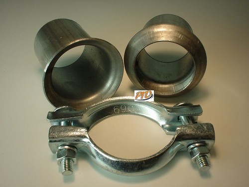

Well my standard GTI replacement Bosal back box arrived for 45 Euros delivered and also bought an exhaust repairt kit on ebay so that I can match the box to my 57 mm line.
I'll see by the end of the week if it's quite enough to give me confidence to drive it on the street.
