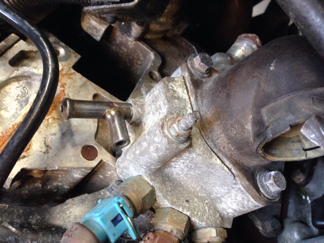

allanallen
  On 3/13/2014 at 10:28 AM, Mattr5uk said:
Ah I can still cut the 16v hose shortened and do away with the "bleed off" that goes to top right expansion tank and blank that. I wasn't sure if how I was going to do it would replicate 8v set up but the bleed off is before the thermostat if that makes any sense?
The best way IMO is to copy the mi16 (I think) set up by putting a hose tail off the t-stat housing back to the top right of the expansion tank. This allows the system to constantly self bleed so to speak. The take offs are available off pug, you just need to carefully drill out the bleed screw hole and press in the take off.

Anthony
That's what I did on my GTi-6 and it works a treat :)
allanallen
That's the one, the pipe comes out at 90 degrees and the bleed screw points upwards ;) put it where you like really but I used the original bleed hole as a pilot for the new un.
Does indeed work a treat

allanallen
That's the one, although mine is the opposite way around, bleed screw on top
