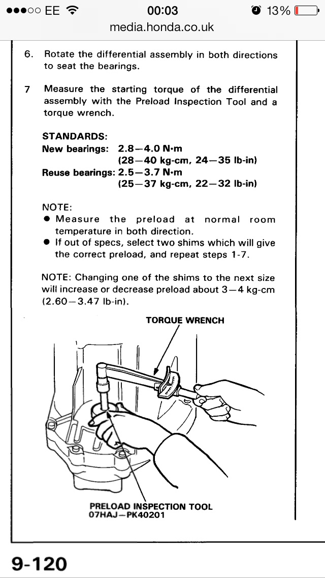

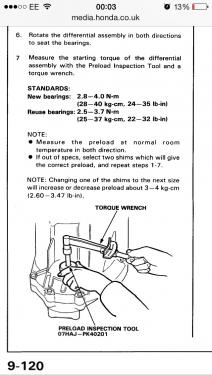

A1AXX 26 2 Cars Posted February 20, 2014 Okay, In the end I found that the diff was still actually rubbing the casing, so no issues, it's all nicely seated and feels good. I researched online about tapered bearing diff preload torques. I found some data for Honda gearboxes (okay not the same, but certainly the same idea). So worth bearing this in mind if you decide to fit an LSD to an Ma5 gearbox, or other. I have found that my assembly, WITHOUT sealant has a starting torque of 4Nm with the new bearings. I had some tight spots at 10Nm where the casing rubbed. I have now ground the high spot out of the casing and I'm good to go. I measured this starting torque using a torque wrench, and a socket glued into the diff, not ideal, but it does the job! I spoke to Quaife again today about it, and they were happy with that. According to the guide, they look for 2.7-4Nm of starting torque with new bearings, and 2.5-3.7Nm when you reuse the old tapered bearings. See the pic below. I love to hear about anyone's opinion on all of this Thanks Josh Share this post Link to post Share on other sites
