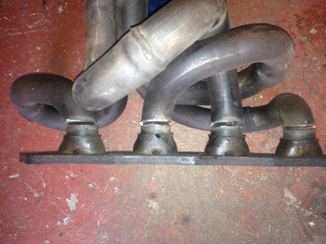

I've gave the fabricator my manifold and explained where to cut etc, is the thickness of a standard cutting blade sufficient to get the new angle?
Not sure what blade thickness he's using, but I know it's a 6" blade......anyone know the likelihood of it being sufficient without further grinding?
dobboy
Does this look about right?
Slo
what on earth are you asking? is this one of those bodges where you cut a slit out bend it round and weld it back up?

Slo, is that not how it's meant to be done?
If not, what is?

yup, that's exactly what you need to do, best bet now is to bolt it to the engine, get the engine in the bay, bend the manifold till its sitting nicely then tack it in place, remove and weld up fully.

Welsh, is there any reason why it can't be welded prior to it going in the car? Or is it so it only gets bent enough, and no more?

thats how i did mine just took the gamble on how much to bend it and it paid off
i just used a normal cutting disc on a big grinder
Thanks Jamie. That was my plan. Did you dress the welds inside the pipes? If so can you remember what you used?

All those high powered gti6 engines using this method on the exhaust. Oh what a bodge.....
It's not as black and white as saying you don't need to do it. We all know the tolerances between one shell and the next. I would always reangle it as even with this done the bulkhead wants right up. I could stick my foot up behind the dash whilst driving and feel how warm it was, and my bulkhead was covered in heat reflective material in the bay.

Well it is a bodge, i had to use this method on my own. Just couldn't see how anyone could judge that photo and say yes that's enough gap now bend it weld it up and the angle will be spot on when he hasn't even put any engine in his car yet.

In that respect yes you won't get it spot on unless you're very lucky. But there is nothing wrong with the actual process of cutting and welding.
