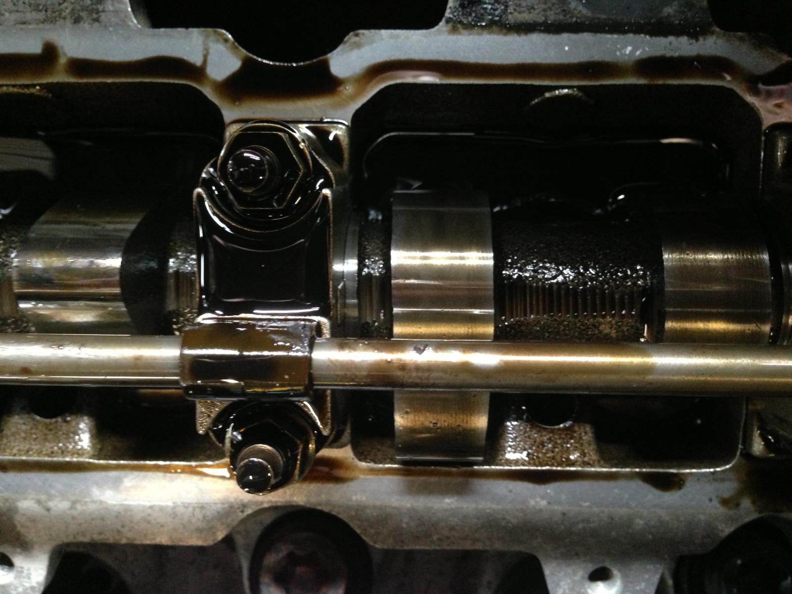

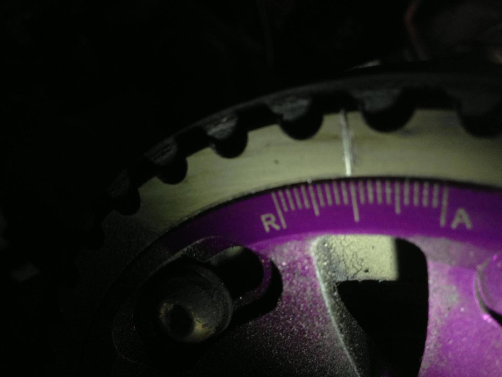

Hopefully theses photos up load. Nothing I can find on the cam to identify it or under dizzy. Not really wanting to remove pulley yet. Profile on lobes look pretty high to me. I have an angle gauge will have to have a hunt round see if I have a dti gauge.

The vernier looks barely moved from the standard position imo, any markings on the cam will usually be on the dizzy end.
How they can state its a 160bhp head I'd love to know, maybe on a good spec 1.9 but unless your 1.6 is very trick, now way, especially not on the standard ecu.
