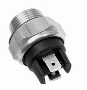

If it's the orginal switch it will proberly be that at fault.
omri617
Can you give me a link of the switch I need ? I believe such switch had never been replaced
farmer
How many electrical pins does your old switch have on it as i think some are different?

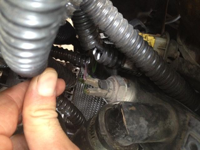

checking in a moment. You mean this : ?
Edited by omri617
ORB
That's it.
Bridge the connectors together and see if the fan runs!

So , took out the wires from the switch and bridged them , waited till temp. reached 70 and above - no fan.
i heard a small relay click (coming i guess where the green + purple relays are) when i connect the wires back
Need to mention again , fan does work - only when pressing the ac button .
