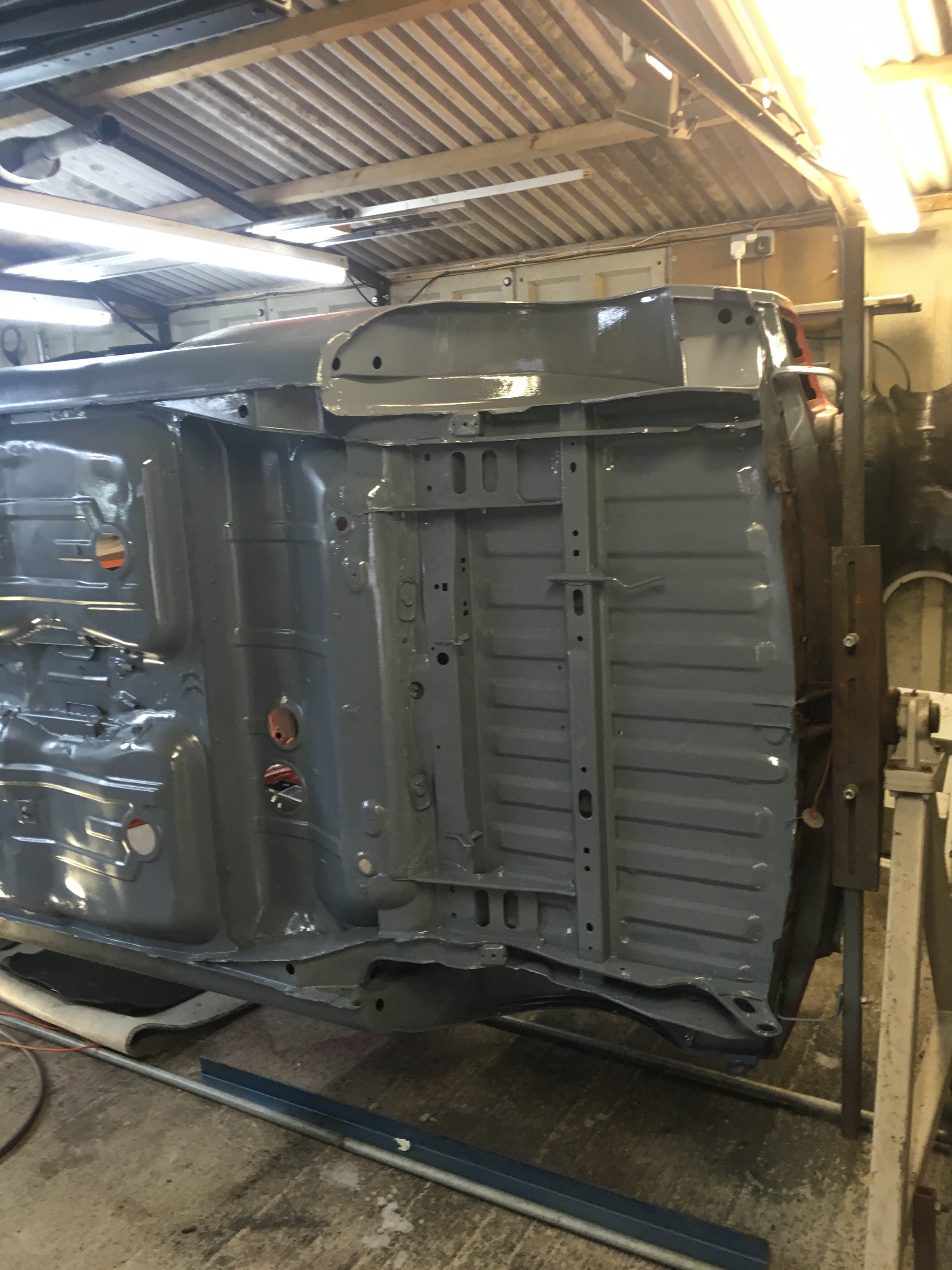

HERMAN

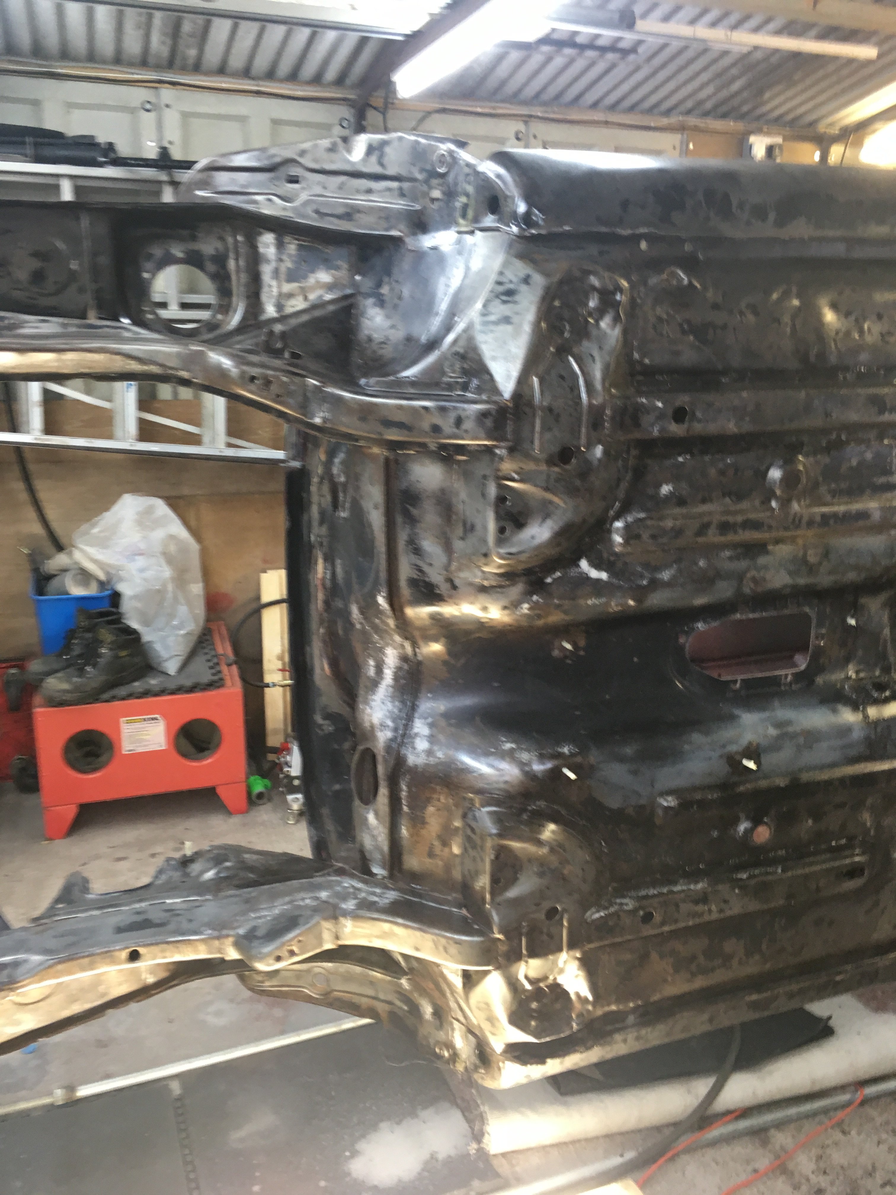

Little update time I have been doing a bit more seam welding and general getting it ready for paint.

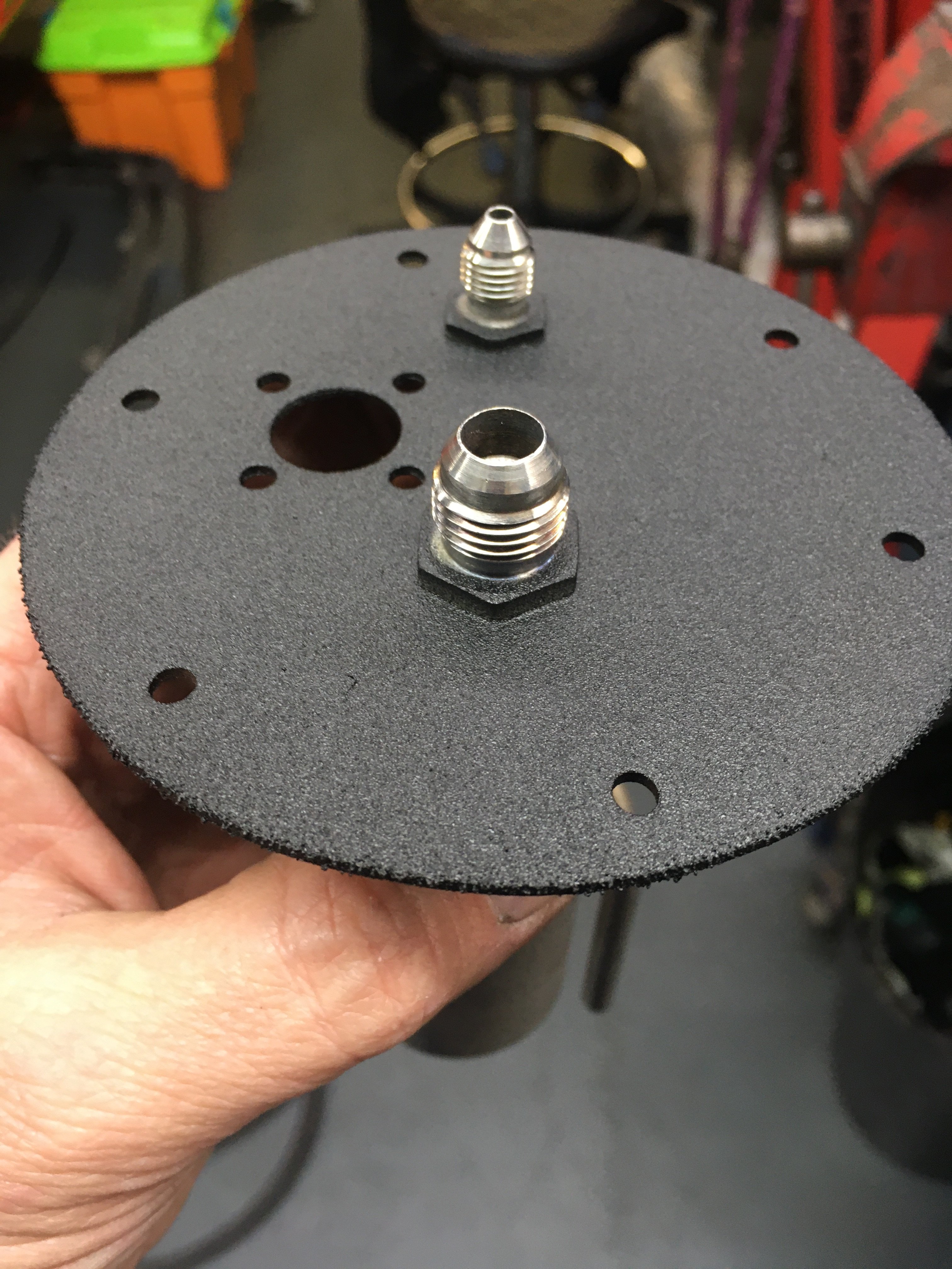

The recent thread on fuel pump housings got me thinking about mine. I used to suffer from fuel starvation on long right handers. So I have got myself a swirl pot and I am changing my I tank pump to a low pressure lift pump to feed the pot. After a bit of messing about with the plastic holder a mate suggested that I do one out of stainless so that I can use AN type fittings.

opticaltrigger
Very nice work Neil,loving the fuel pump mate.

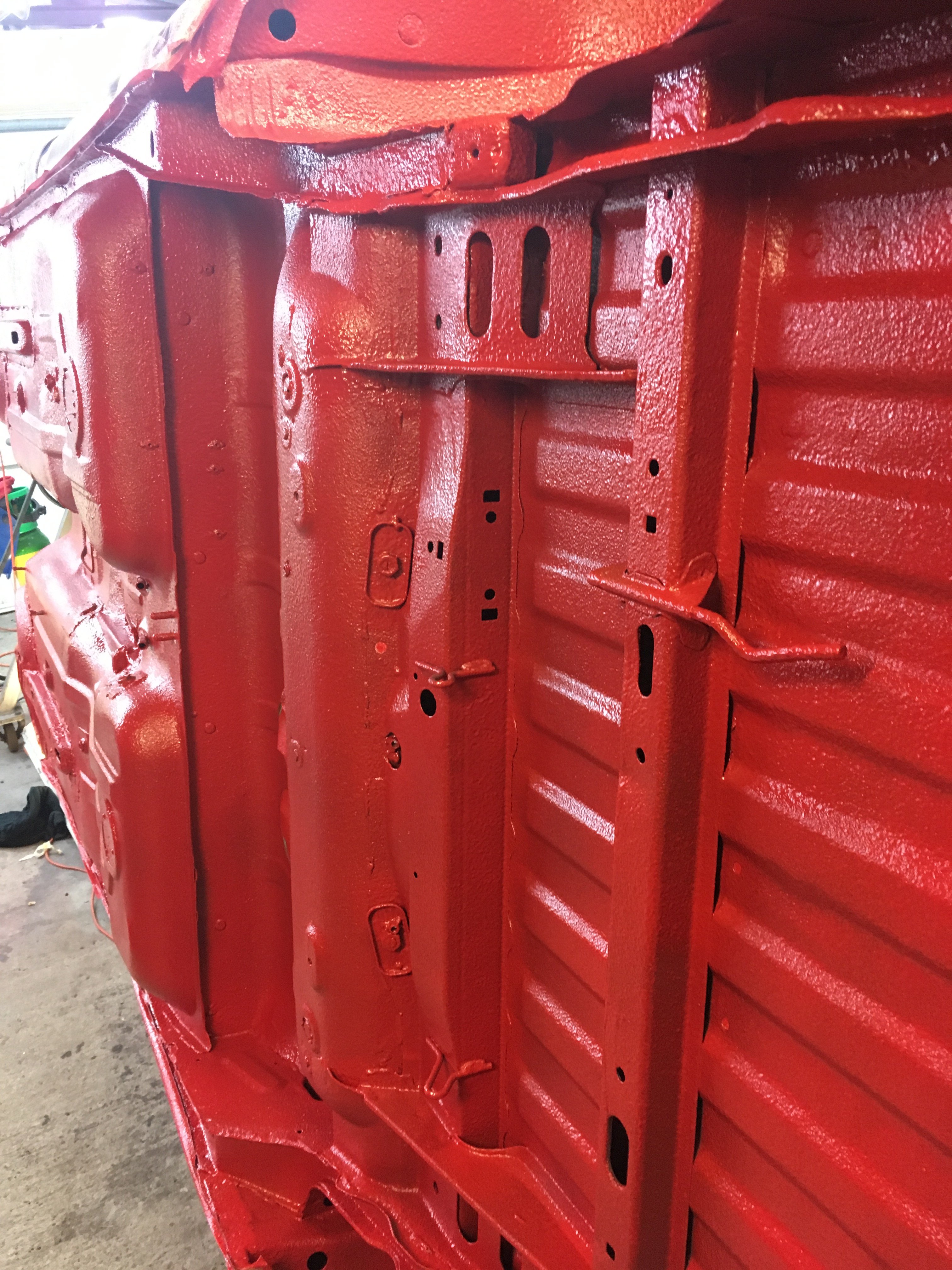

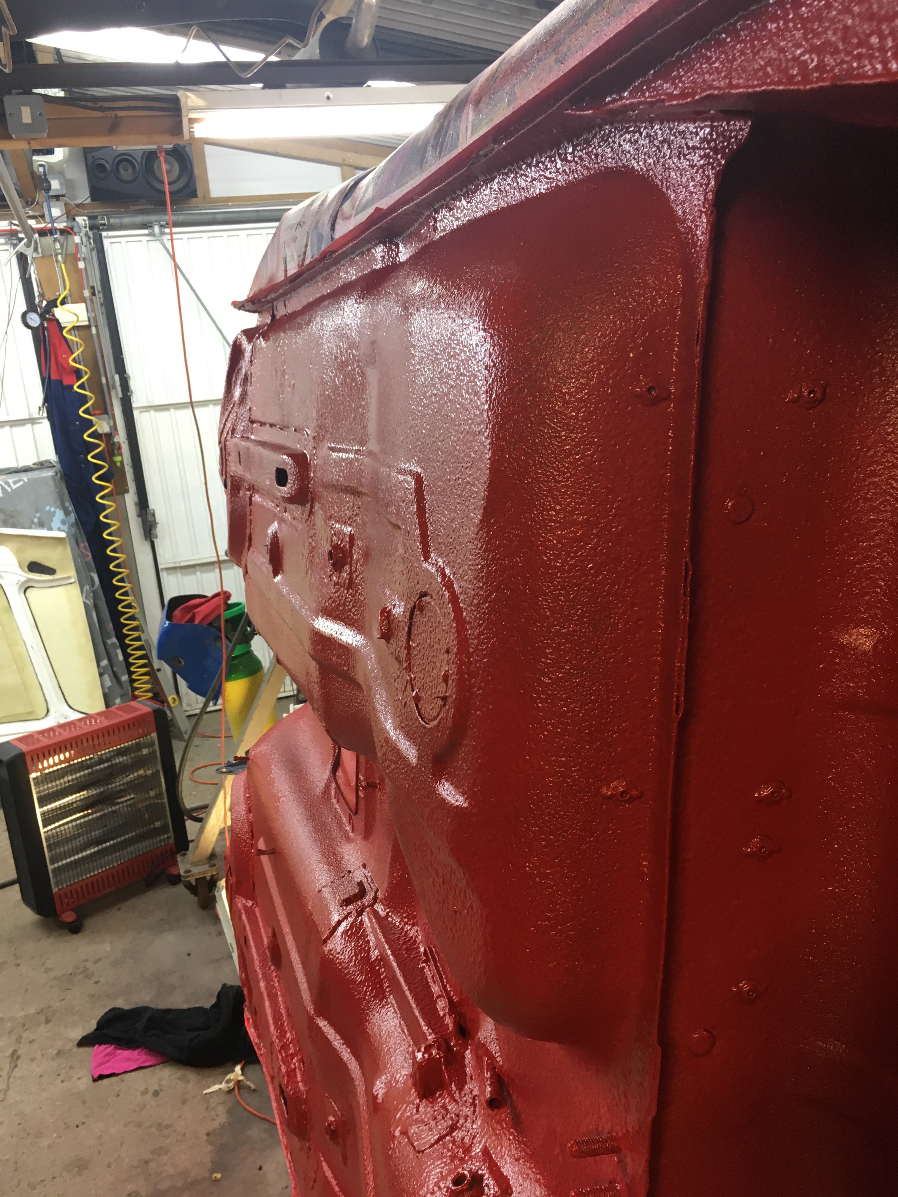

Yes I know it’s been awhile but here’s a little up date.
underside has been cleaned and primed and a coat of upol Raptor with the red paint mixed in. The lady at the paint place gave me base coat and not red pigment by mistake and it gone a bit pink. So it’s going to get a coat of 2k in the proper red colour.
Of to the paint shop in a few weeks.C1B14266-218F-4217-8DC8-CF91A6B8770F.thumb.jpeg.ed22febe9b8fcc5904a3969b3d2ea487.jpeg

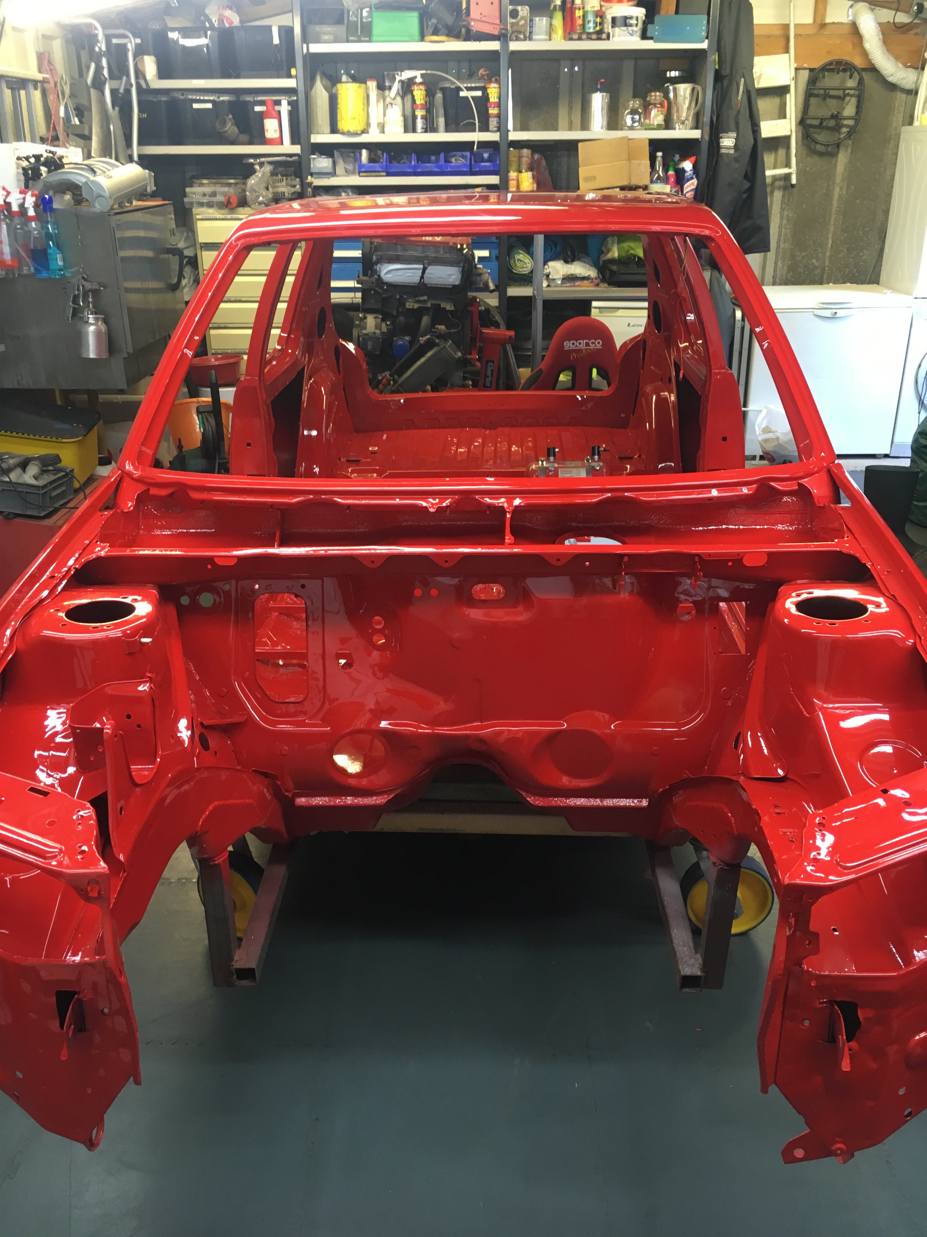

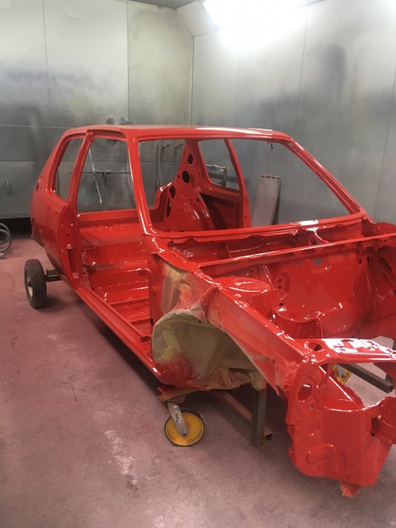

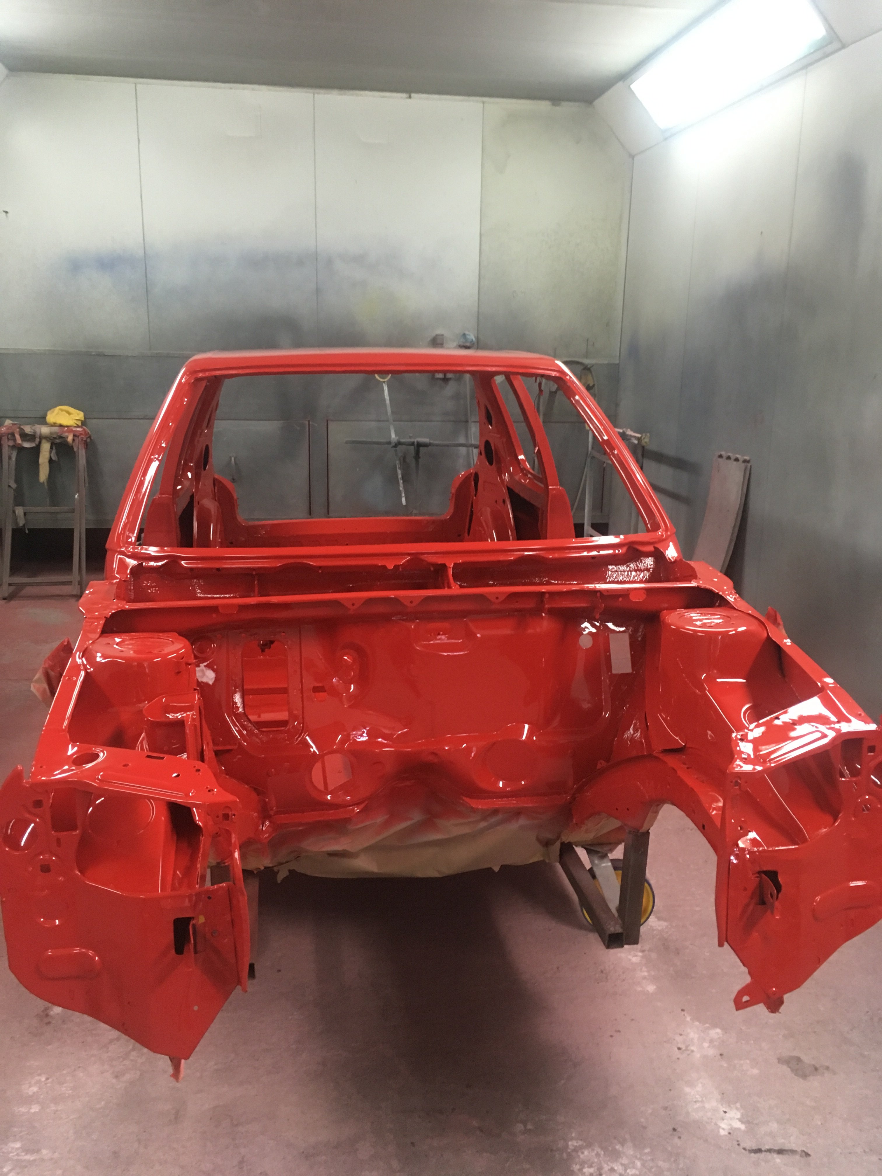

HERMAN
Painted at last.
HERMAN

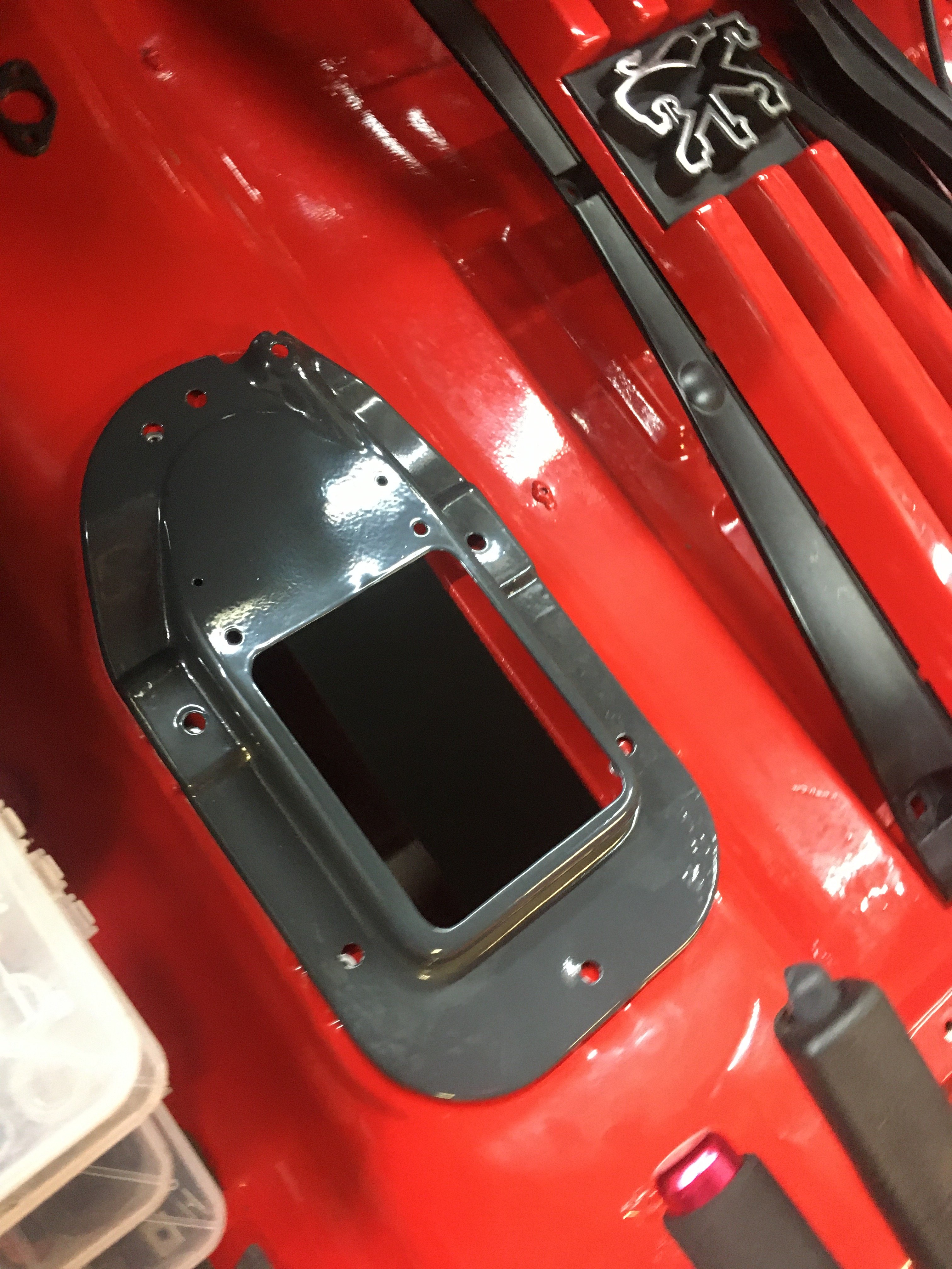

More powder coating
Edited by HERMAN
HERMAN
Looking very smart
dale205mills
Nice paint work, do like a red 205.
21 hours ago, HERMAN said:
More powder coating
I like this a lot, just checking you have realised that the 6 mounting holes have one that isn't equally spaced?
HERMAN
Yes mate used the old one as a template. Cheers
