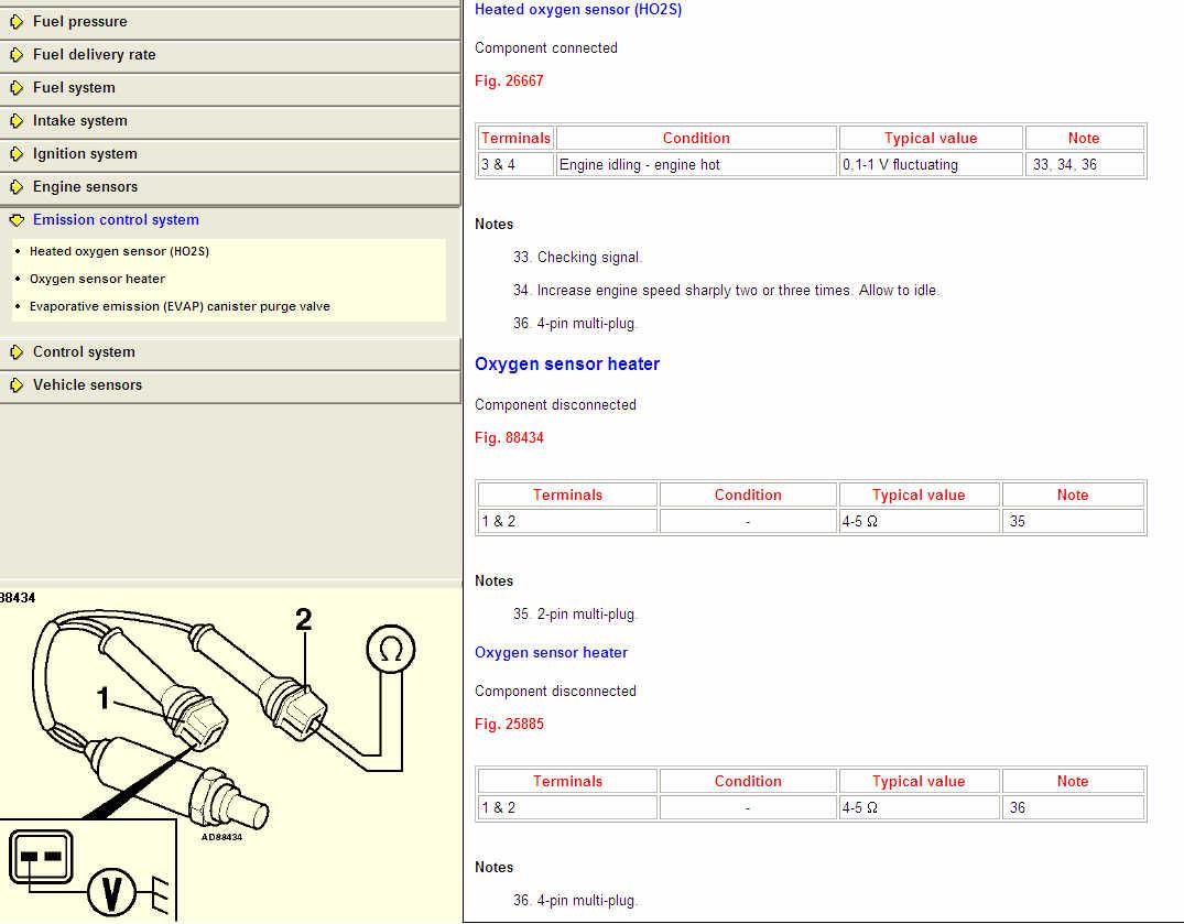

pug_ham
The only tests listed on autodata for the lambda sensor are voltage checks & a resistance check of the O2 sensor heater;
g
nixonmi16
to test the o2 sensor connect a volt meter to the supply to ecu norm the black wire on most sensors it should switch from 0 to 0.8v very quicky at 3000rpm.if stays still blip the throttle and it should shoot up then back down. an air leak before the o2 sensor can cause a rich mixutue as can a missfire all the sensor reads is air.
