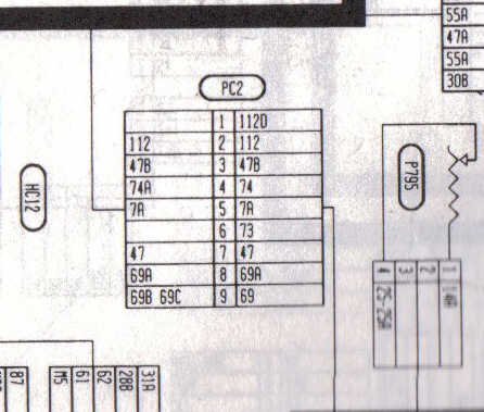

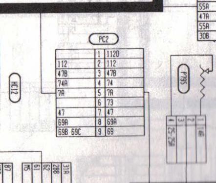

pug_ham
I ended up having to use the diagram for a 1.9 GTI as the haynes manual doesn't list the 1.6 other than in 1986 on which doesn't include this plug breakdown.
This is plug # PC2;
It is wire 7A & runs to the alternator as you found out.

Ryan
This is plug # PC2;
g
Which Haynes manual is that from? Both my copies have a different style of diagram to that.
pug_ham
Its just from a different publication of the old Haynes 932, the code inside the front cover is 932-6R5 published in 1989 for up to 1989 models, I've both types of wiring diagrams but these are the orignal peugeot diagrams I understand.
