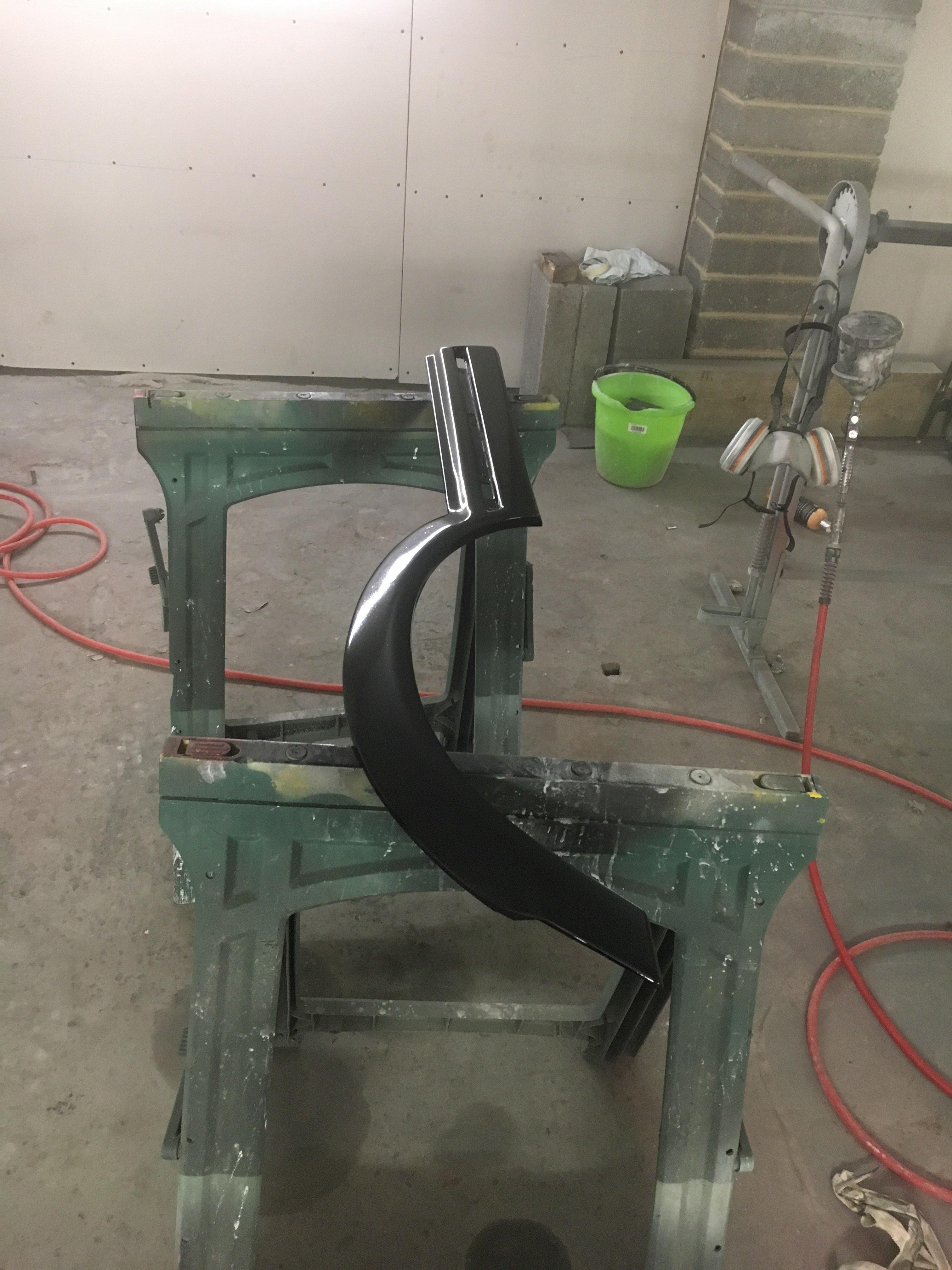

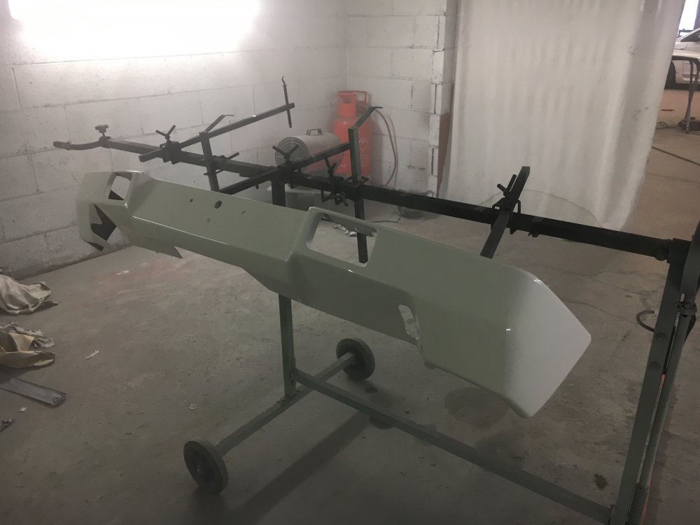

So a few bits done firstly got the arches and bumper on for a brief test fit
Gave the bumper a flat
Got the front verlance on the table and in primer
And then painted

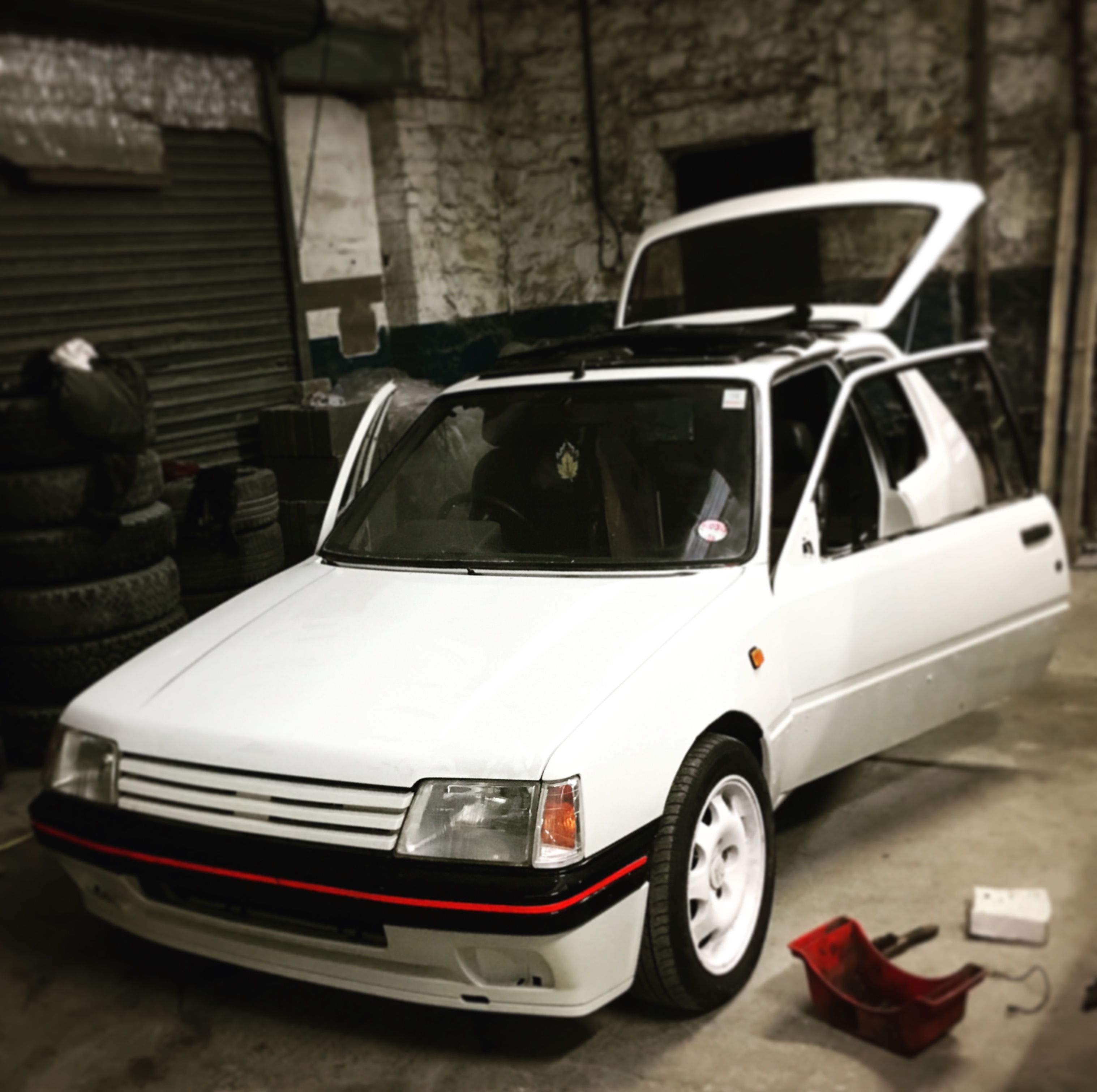

So just a quick fire update on the old girl basically life kicked in and the project stopped pretty much after the last update sat in the garage for 2 years but due to an unfortunate change in my personal circumstances I decided I need to finally finish what I started a few years ago , she has progressed a lot over the last few months i will get some picture of her and post them up over the next few weeks
Kezzer30
Quick snap for a last week will update more soon

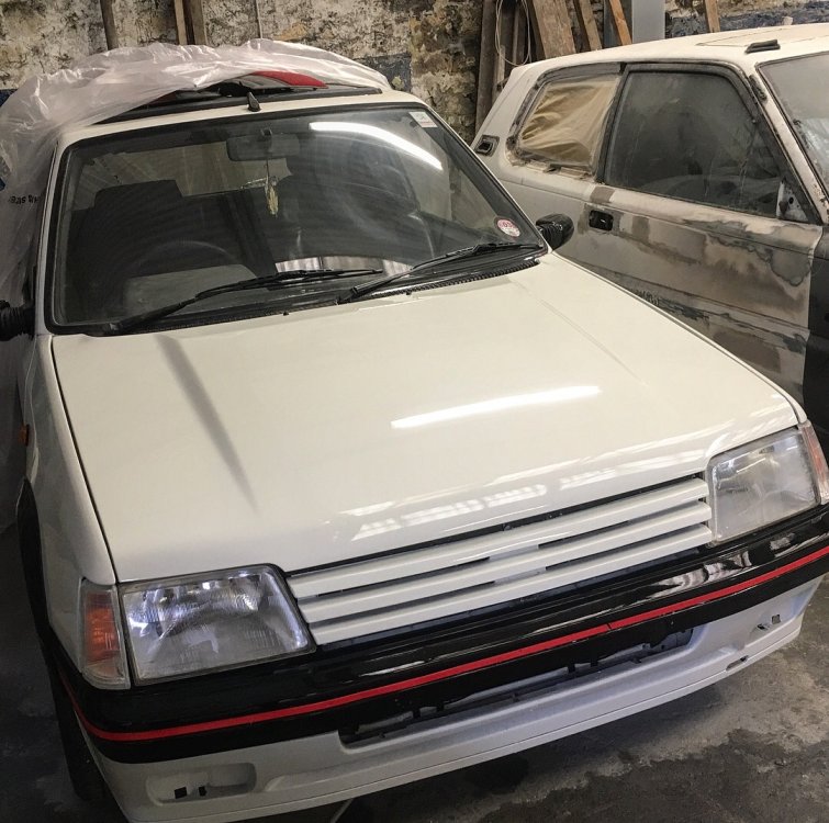

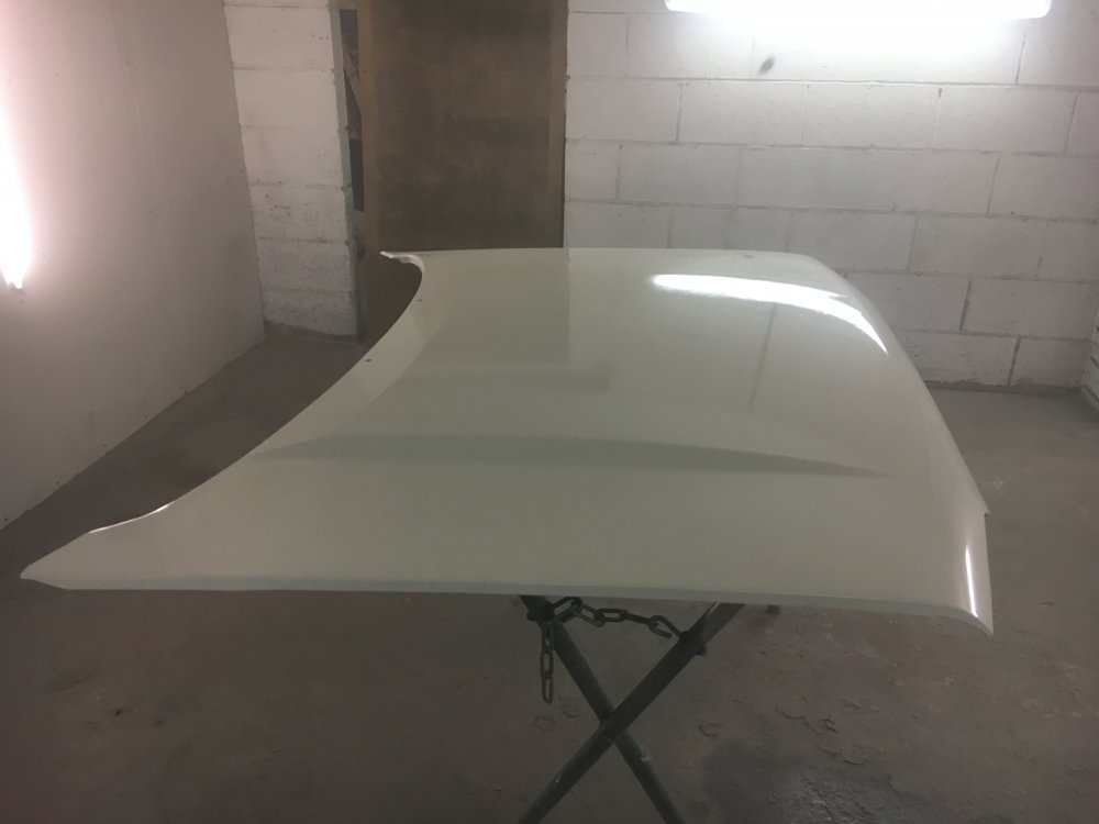

Few pics of her as she is atm and the bonnet and rear valance in paint from today .
Will try to keep this updated
Kezzer30
Ok so more done today , flatted and buffed the bonnet , white is perfect now so happy days , washer jets now in Aswel . Still awaiting auto electrican he's proving hard to get hold of due to him being in high demand but hopefully will be with her in the next few days .

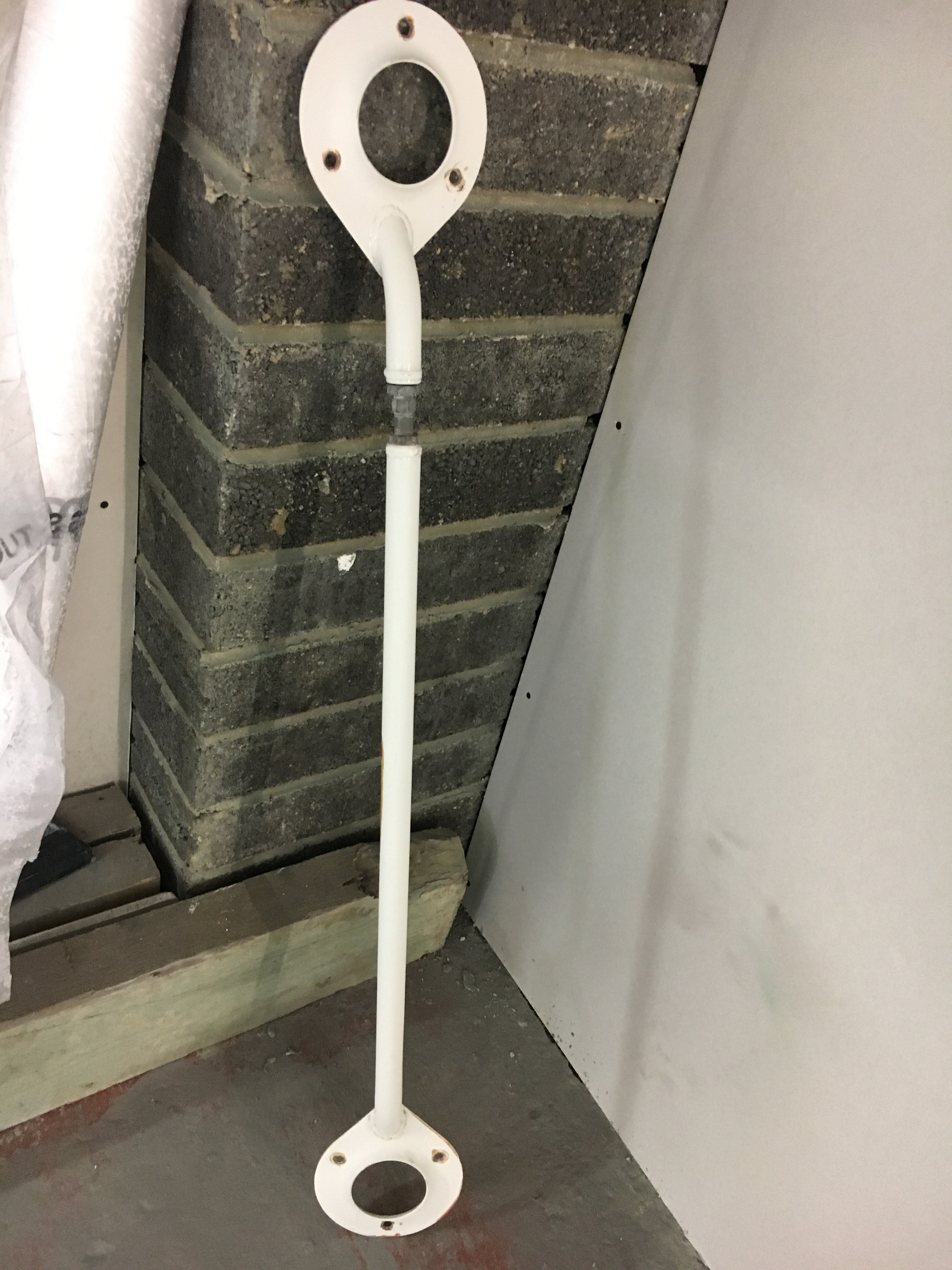

also the rear bumper and strut brace painted gloss black . Hopefully be able to put rest of kit and rear bumper and verlance on tomorrow night .

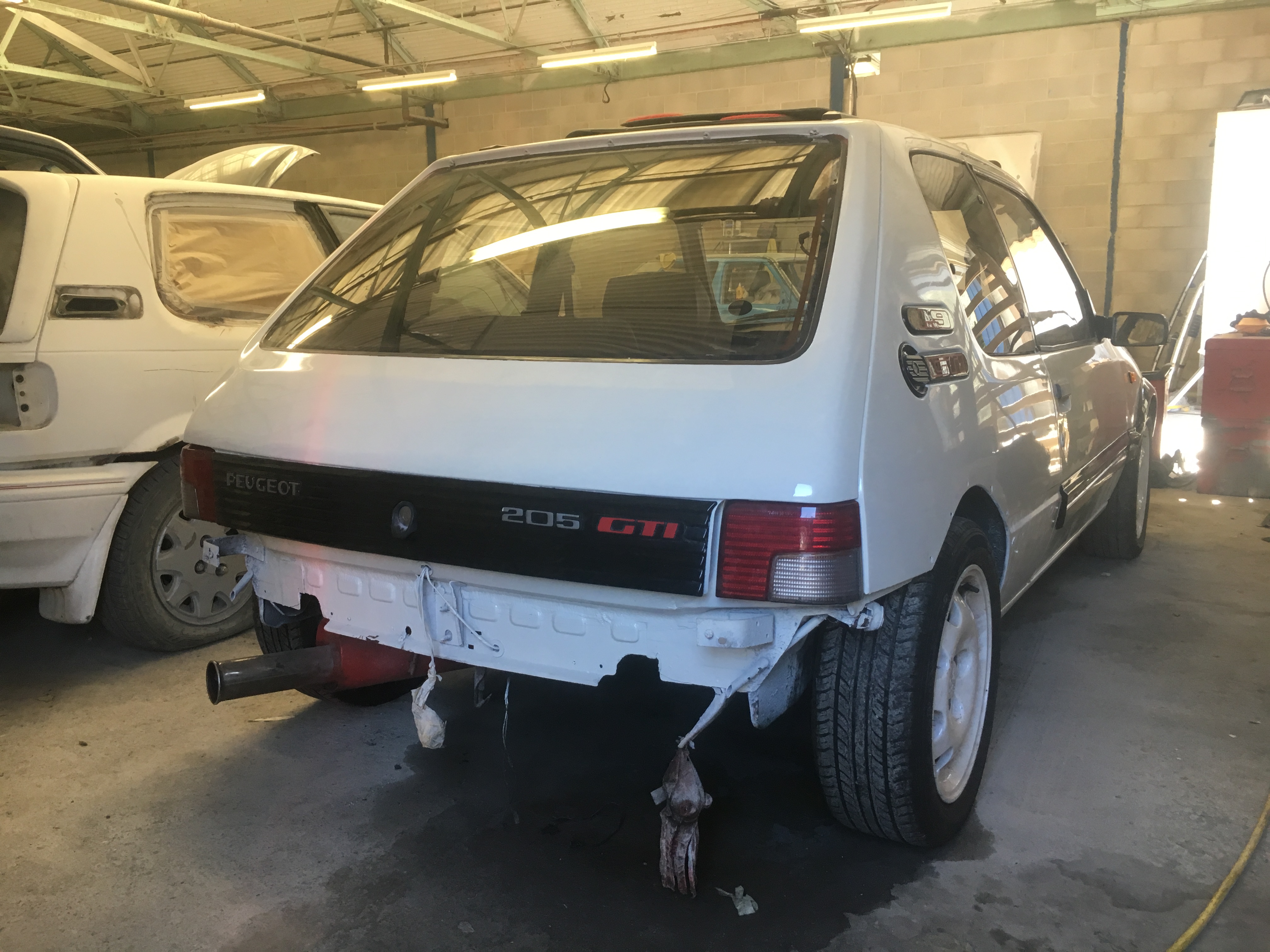

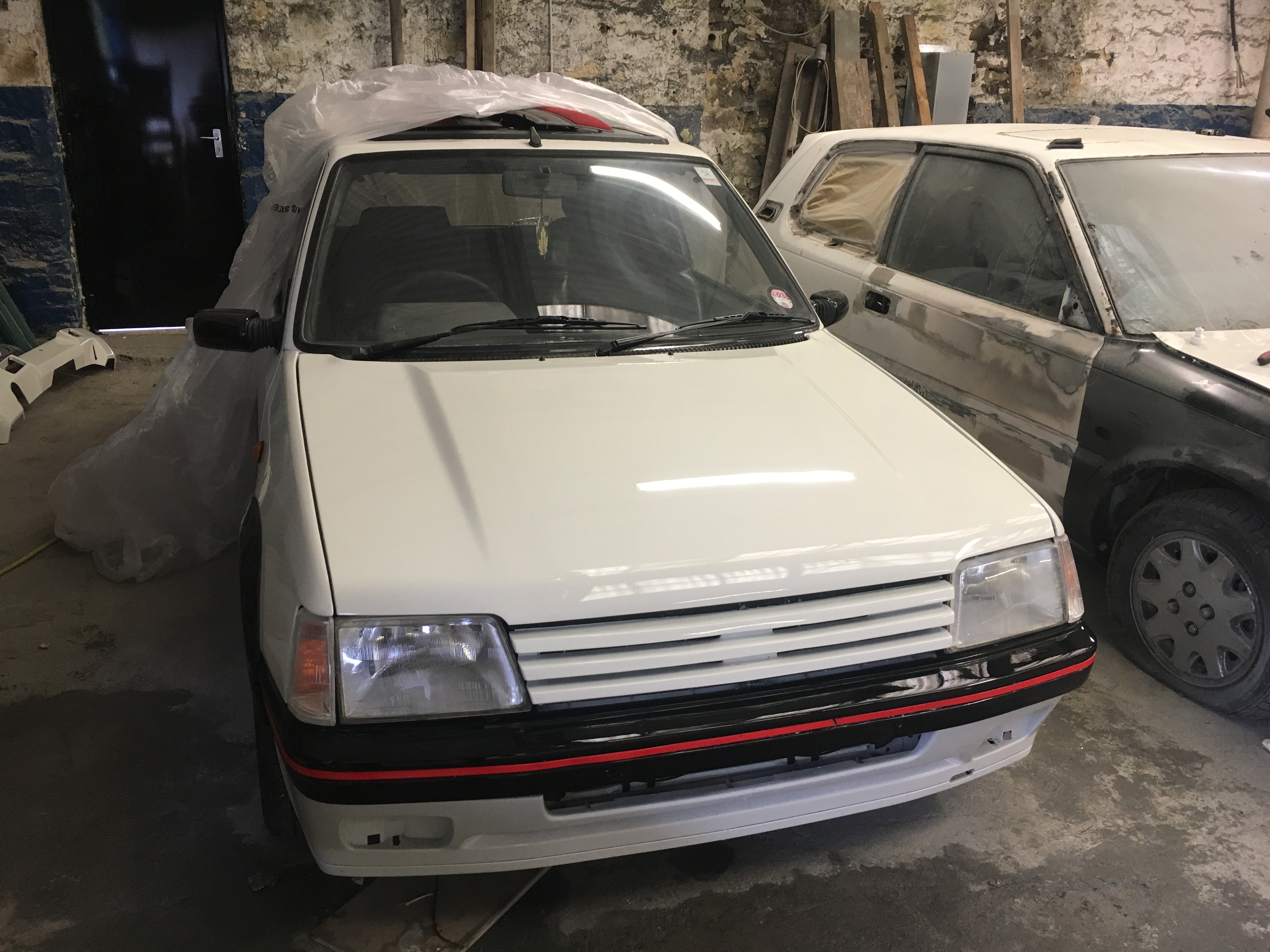

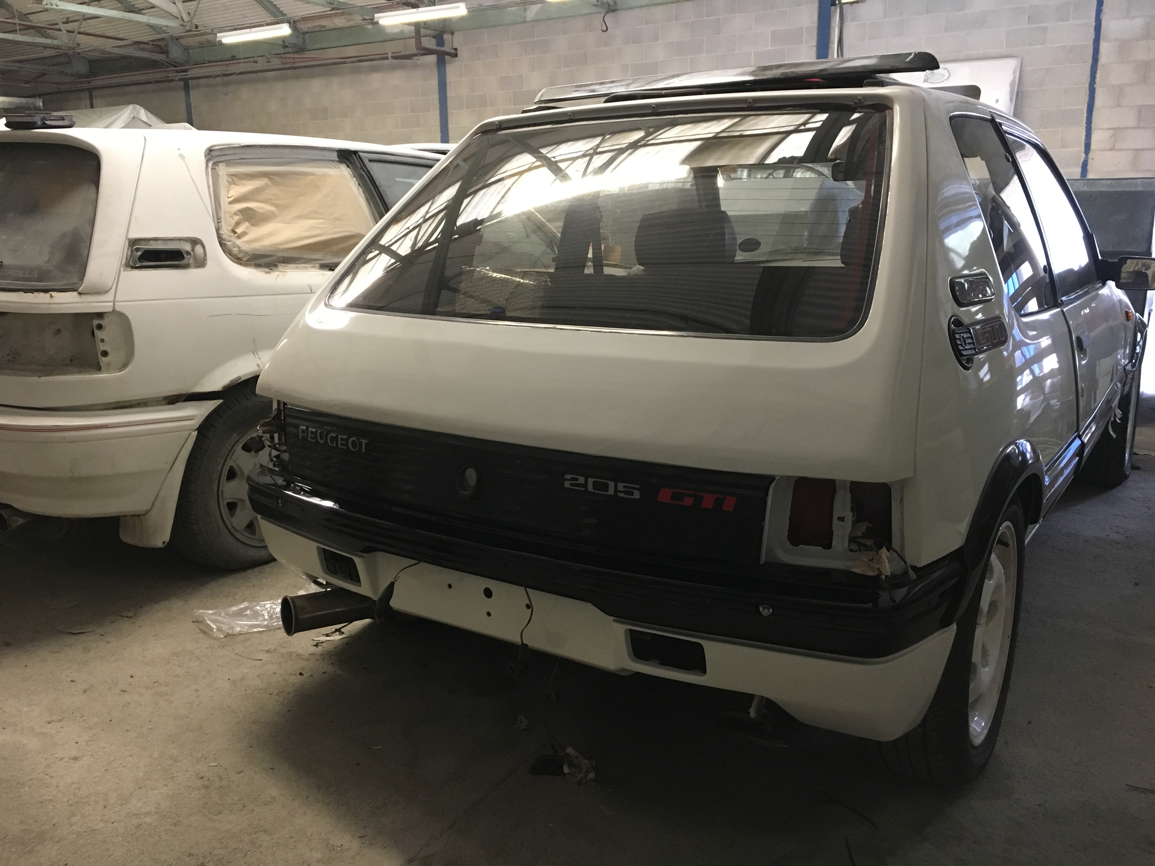

So fitted rear bumper and Verlance and halilua the electrician turned up and has decided that due to the fact ever man and his dog and Mickey Mouse has fondled with the rear lighting loom that it would highly benefit from being pulled out and rewired . I agreed so he hopes to have that all done by end of next week so happy days .

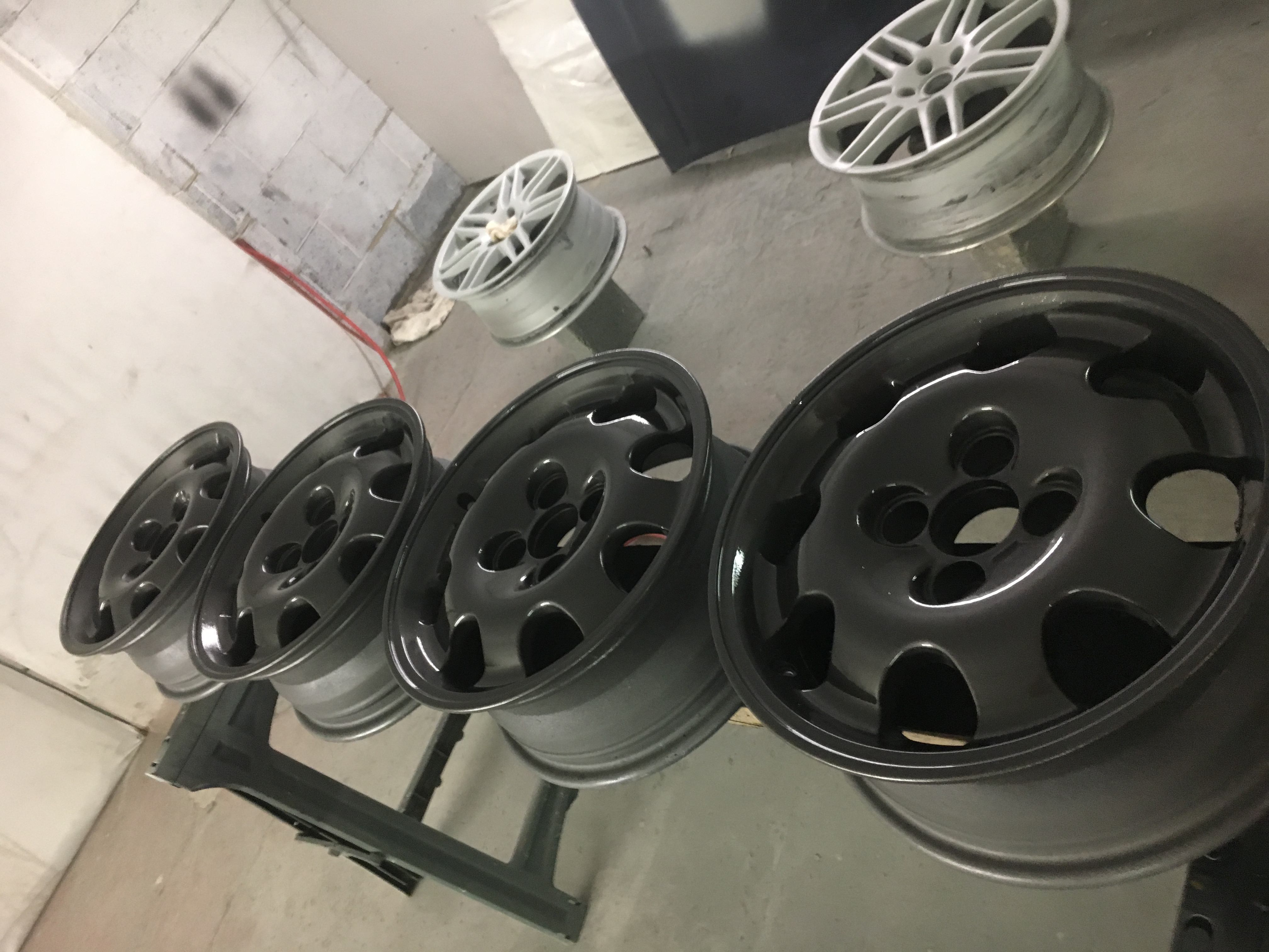

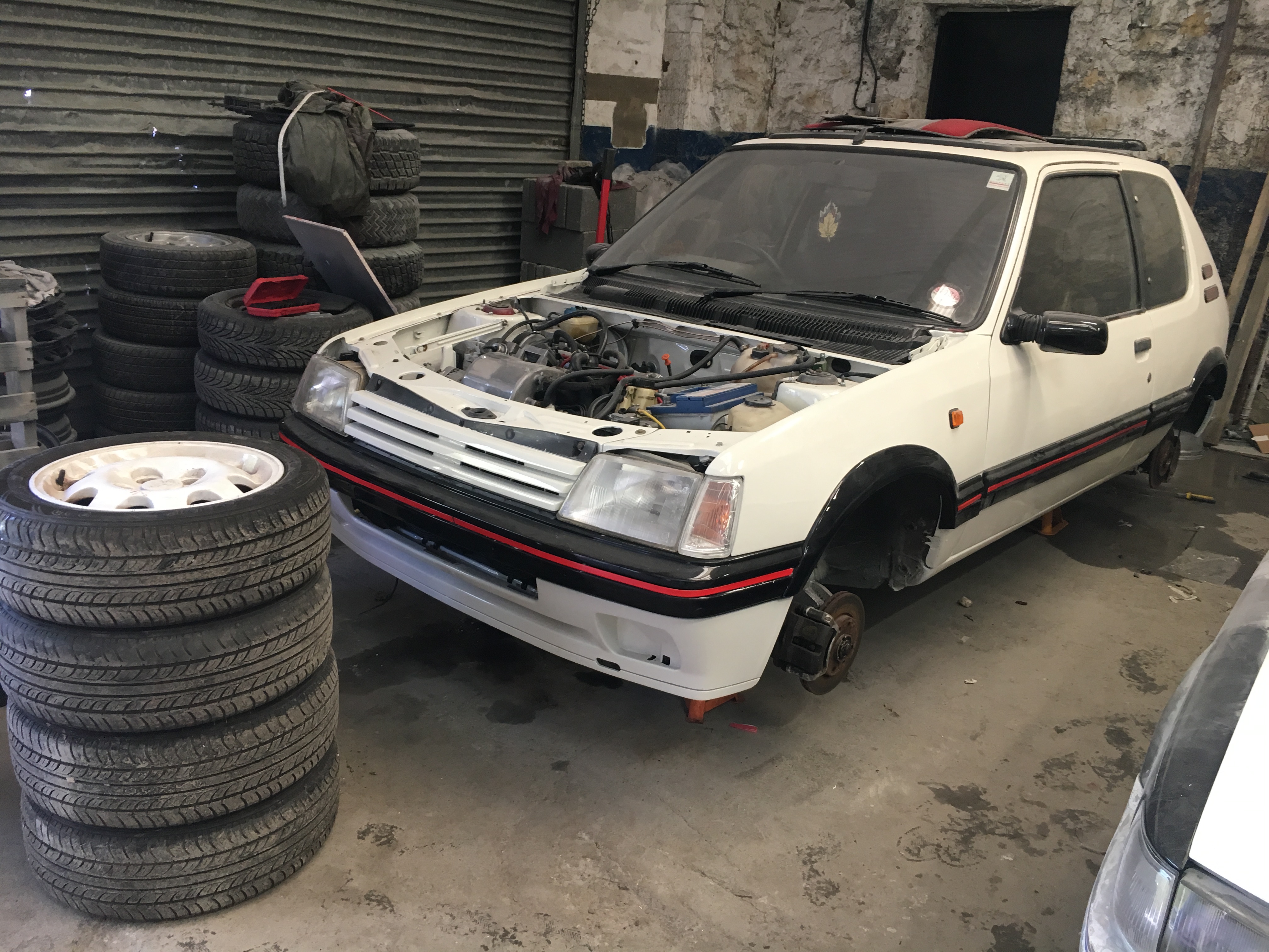

So had a think and spoke to someone who does shotblasting decided to send the bonnet to be blasted as after over 2 hours with a da sander I'd only managed about 20% of the bonnet . I thought while I'm at it may Aswel whip the wheels off and send them off too . Still no sign of the auto electrician have replaced the broken headlight and currently have a power steering pipe in the post to try and fix this leak . Hoping to have most of these bits sorted by the end of next week . Will keep you all updated
Kezzer30
Small update , went down today hoping the bonnet and wheels would be back but unfortunately not yet , replacement power steering pipe turned up so decided I'd replace that Aswel as the water pipe that needed doing and all I can say it was a pain in the f******* arse , after much swearing managed to somehow get it sorted not fully tested to make sure no leaks but I'd be very surprised if there is any etc . Still awaiting the auto electrician not too far away for hopefully sending her for an MOT . Will keep the updates coming .

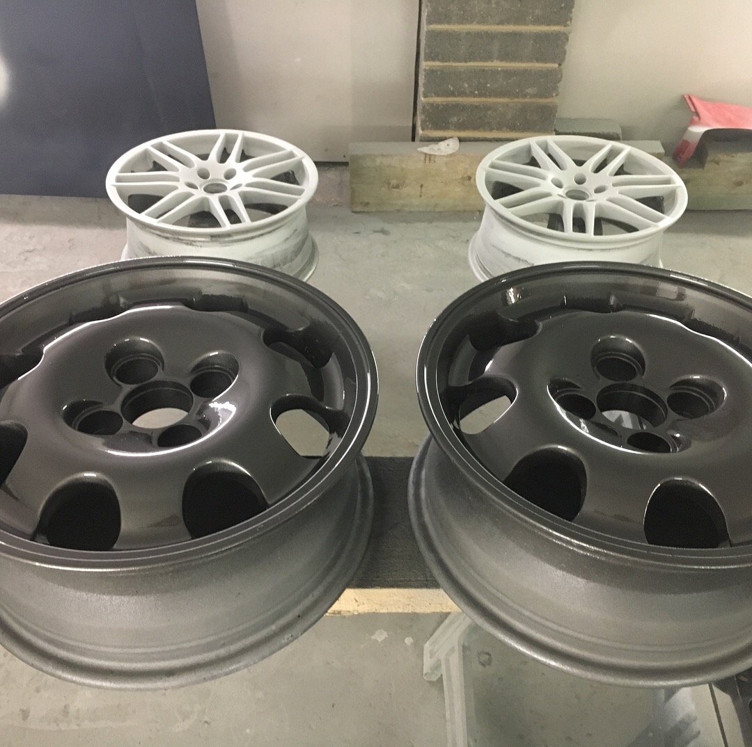

Painted the speedlins today made the colour myself wanted something a tad different
