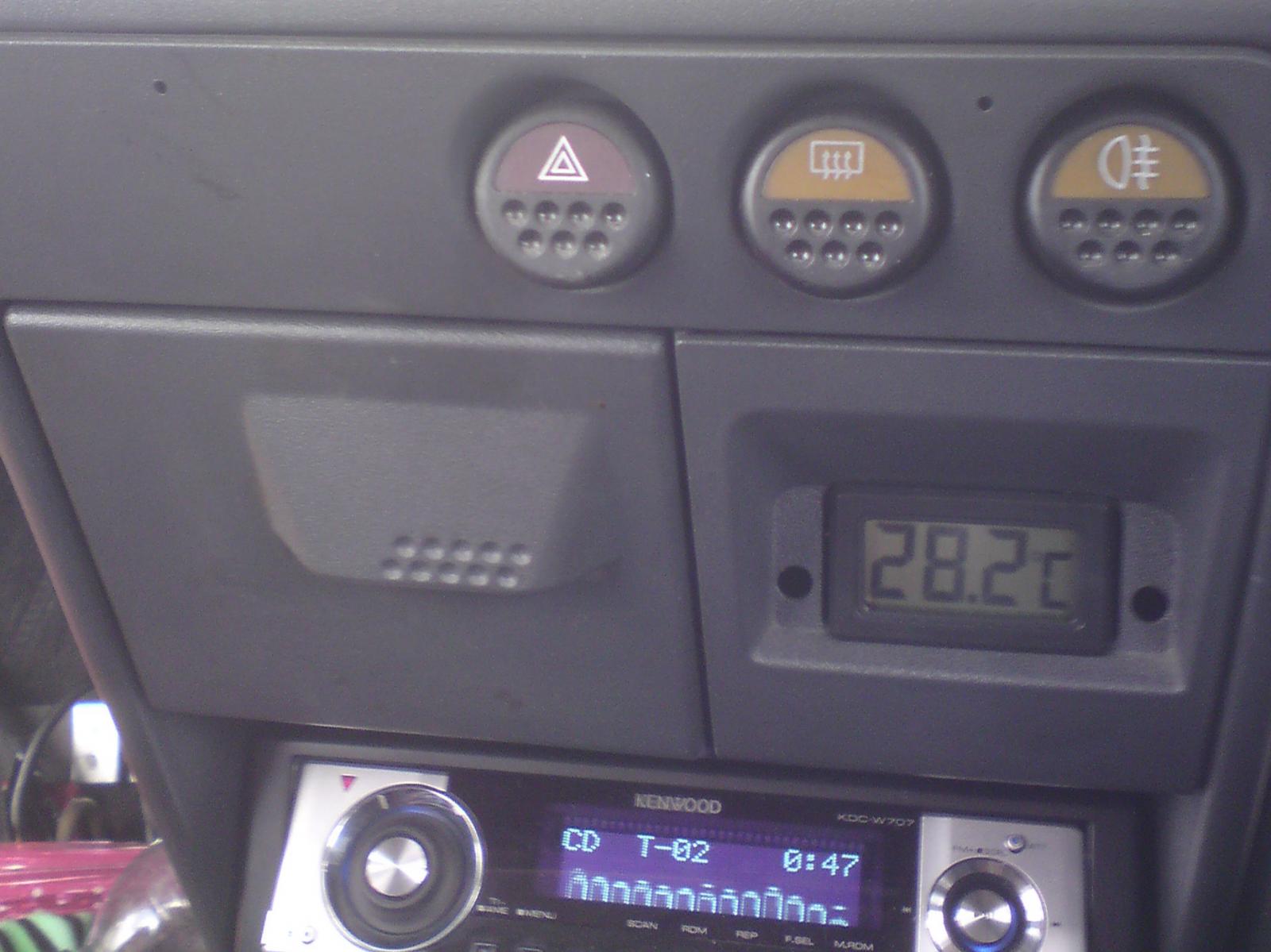

Heres how i got my temparature sensor in a pipe:
You can see the actual sensor screwed in at the bottom. This is custom made but i've seen many people with these - you must be able to buy them from somewhere, failing that if you go in any enginieering place with a half decent drawing they will be able to make one up quickly and cheaply.
