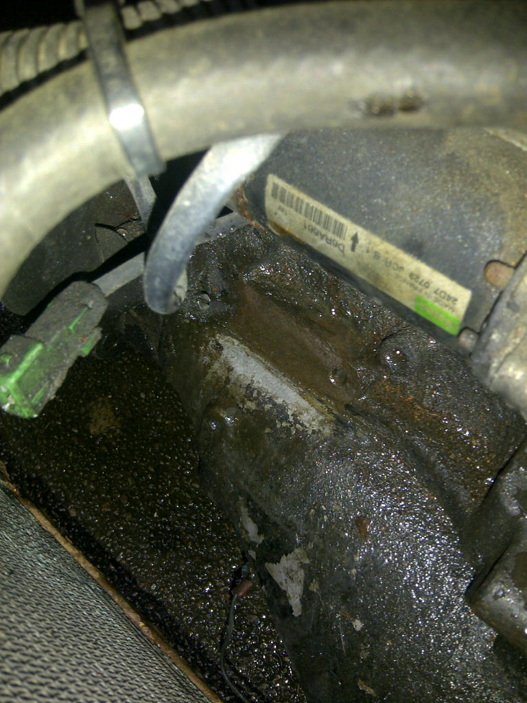

I know this has been asked a few times, but I am trying to find the engine number on my GTI-6 lump as the insurance company want it because the engine has been changed.
I have attached a picture which is just below the starter to the right of the oil filter - is this supposed to be where it is? is it on a plate or stamped onto the block as it doesnt look like anything is there? Is it anywhere else that I can check?

that's where it is stamped, good luck trying to read it though, most have gone pretty rusty and hence illegible, no idea what it will be though, best bet if you really need it is to check the v5 of the donor vehicle, or just make it up.

so it is stamped on there and not a plate? I will try some emery paper and chalk to see if I can see it.
The isurance company were being realy difficult about it, saying it will be checked in the event of a claim etc to make sure its the engine I have said it is.
No donor vehicle unfortunantly, the conversion was done years ago and over 2 oweners ago so finding where it came from will be difficult

It's stamped and raised lettering. As mentioned, you will do well to find it. I was lucky with mine to have a low mileage and fairly clean block so it was easily visible.

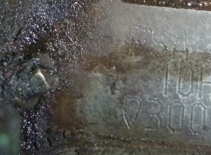

it seems luck was on my side, a wire brush on the end of the dremel and it cleaned up nicely so the camera could get the whole number
The odd thing is the symbol at the start of the number on the bottom, I would assume its a zero, but looks different to the zeros to the right, the same symbol is at the end of the numbers as well, any ideas if they are supposed to be numbers?
