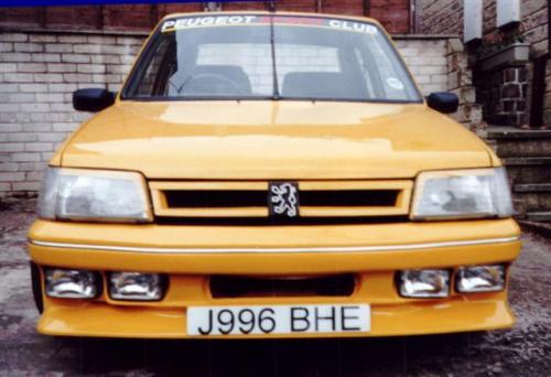

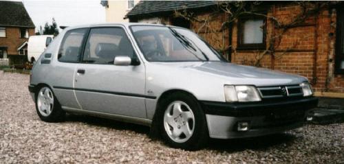

I love the upright park pos, don't know how practical it is but would love it to park like that with ignition off, just to look cool :lol:
Mine passed MOTs like this with that being the park position, though both those pics were mid 1990's when Touring Cars were all like that. It never bothered me as I have had a split screen Land Rover in the past and it did reduced wind noise (and therefore aero drag which was an extra 10 bhp in real terms!!)
