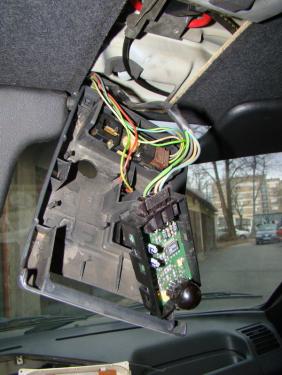

Bit of a complication with my old Pug' tho'? It has a Scorpion immobilizer fitted combined central locking, and although it works, I only have one blipper. I'll remove the receiver (not sure how to do that?) and refit into new pug', and see if it works? What do you think Anthony?
Ahh! I see. so is it easy to take out the receiver from the panel? I think I have the answer then? My dead 205 has central locking, so all i have to do, is remove its receiver and install in the new one and sort out the key issue? I'll look in the Haynes see if its covered in there. Thanks all for you help.
Take the map-reading light out of the roof console to gain access to a single bolt holding it on.
The rest will be pretty obvious (if not, here's a photo for you).
Refitting is a reverse of removal and Bob's your mother's brother :D.
