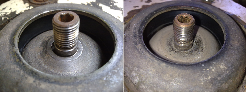

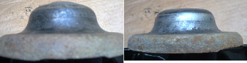

So, this morning I took both top nuts off the struts (while still in car, on it's wheels) and removed the inverted cup. In doing so, I was able to compare both cones and it immediately became apparent that something wasn't quite right...
The o/s cone was flat-topped (as it should be) however the n/s one was domed, see pic (dodgy one on the right)...
Once I'd taken the struts off again, it was even more apparent...
It was the n/s strut (with the domed cone) that had the washer missing, so it''s apparent that the washer is there to add strength. I'm guessing that at some point maybe a centre nut has come loose on an event with a previous owner and the strut has hammered into the cone (normally it would be clamped tight). The underside of the cone showed quite severe wear caused by the strut moving against it.
I'd not realised that the cone shouldn't be domed like that since this was the first time I'd had a 205 strut apart, and I'd been doing one side at a time.
Sourced a decent cone and another washer, put everything back together, and hey presto, no more clonking and the struts show equal amounts of threads now. Job done :)

Christ that's bad, I know on the phone you said it was conned up but....
timmsy19
wow that is coned!!

Common fault on 106's is the insert popping through and bending the bonnet on rough events.My dads had split after about 3 enduro rallies.
So welded a washer on the underside and it's been fine ever since.
Done the same on my 205

There should be a thick washer between the insert and the bell (which is what was missing on one of my struts) and a thinner washer on top of the bell, that the nyloc bolts down on.
