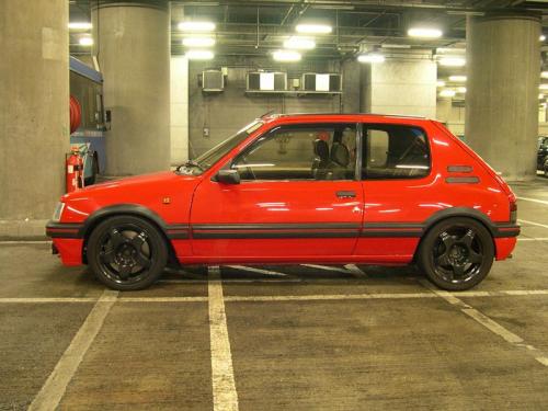

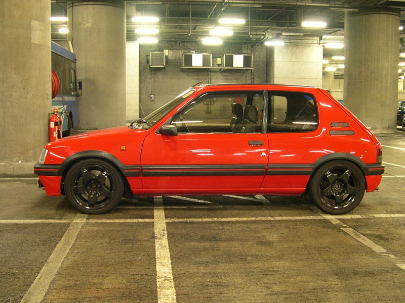

I had Compomotive MO 16" running on 195/45-16 before. the calculated diameters for them are 585mm and 582mm for 185/55-15 and 195/45-16 respectively. it was actually a tad smaller but i guess it can be ignored since difference manufacturers vary in size a bit.
Currently running the 195/50-15 since it gives more choice for selection.
by the way the 16" fit very well and look COOOOOOL!
Strictly_Derv
That does look pretty good. I've never been a fan of big wheels, hence the 13's, but certain wheels can get away with not looking chavvy.
I've been offered some white banded 14's now, not mega wide or anything.
