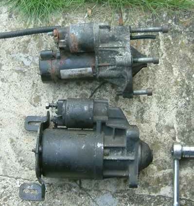

These slim-line starters; can someone post a pic of one? How 'slimline' is slimline?!

New vs old:
Mine is from a 406 diesel, and says 1100W on the sticker. I think the petrol ones are somewhere around 900W.
most tend to be 1.1 or 1.4 KW, diesels will be geared down, petrol direct drive.
Some Mitsubishi starters are slimmer than the valeo units, but only remember seeing them on a diesel, not that it makes much difference, they are significantly smaller in diameter than the older 205 8v and most 1.9 16v engines.
havent got a pic of the smaller bodied unit to hand, only this one of the old ones.
