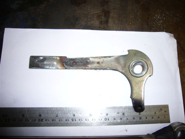

Miles 331 1 Cars Posted January 8, 2012 I never bother as making the shift to quite can make the box Bulk, I've taken more off than fitted to give you an example but if you need to you can make a free one by shortening the 'L'/Quadrant on the short side with cutting and welding or using a new Ball. Basically if all the linkage is in good condition the change will be good Share this post Link to post Share on other sites

engine killer 6 Posted January 9, 2012 Instead of shortening the 'L'/Quadrant on the short side, I prefer lengthening the 'L'/Quadrant on the long side by welding an extension with a few holes to give adjustability. By shortening it you only get one shot/chance, but lengthening it you can always go back to original as you wish. Share this post Link to post Share on other sites
GLPoomobile 958 Posted January 9, 2012 By shortening it you only get one shot/chance, Nope. I shortened mine by drilling out the original ball on the short side, drilling a new hole a few mm inboard of the original, and then fitting a new ball supplied by Miles. I can then easily revert back to standard by just moving the ball back it's original hole. I'm another one who prefers the standard throw, though. If everything else is in perfect condition, standard throw feels much nicer IMO. I find the shortended throw feels a little unnatural - not vague, just feels a little disconcerting, as if you've not slotted the gear all the way home when you change. Probably just a personal thing. Share this post Link to post Share on other sites

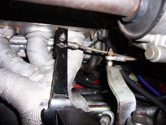

GLPoomobile 958 Posted January 9, 2012 (edited) Bushes and gear rods will probably make a massive difference unless they were replaced in recent years. Get some upgraded rods from Miles at Pug Racing (search for his ebay store). They have clips in the ball joint cups that secure the rods in place. With standard rods, over time the cups get loose on the ball joints and it's only a matter of time before a rod pops off mid-change. Trying to pop them back on with your arm next to a red hot exhaust manifold isn't much fun. For the bushes, I've heard that just normal OE replacement plastic bushes make a big difference if yours are worn. Then you've got the brass versions (I've got some from AB Motorsport) but I'm not keen on them as they can be a bugger to get right and sometimes need griding down otherwise the shouldered bolt clamps down too far and stops the bracket from moving (meaning you have to back off the bolt a little bit, but then it can work loose and pop off). Mine needed quite a bit taken off them and still aren't perfect. I'm pretty sure there's another type that use a bearing and fit better. If I was doing it all again, I'd just go with a standard shift, OE bushes, and Miles' gear rods. Edited January 9, 2012 by GLPoomobile Share this post Link to post Share on other sites
