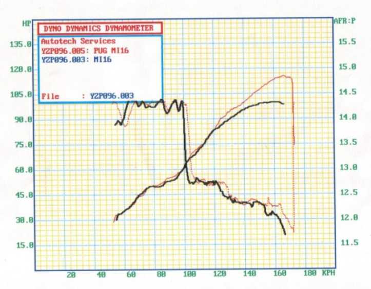

After months of trying get my 1.9mi running correctly it's now running superb.( All be it with different bodies and management)
It's took a bit of time and money to get there but I got there in the end.
Have to say I'm more than happy and the guys were more than helpful and took a real interest in mapping the car so I can't recommend them enough.
Anyway here is the graph for the car.

standard engine?
whats the exhaust and inlet on there?
craig_007
Bottom end is standard but was given a rebuild by myself.
The inlet is a petert S2 and exhaust is a piper BP270 regrind as it was already in the head when I bought it (Unknown to myself the car had piper inlet and exhaust cams)
The head has has a slight skim at some point
Yes, well done indeed. Flywheel numbers are always rubbery but 163hp at the wheels is very impressive indeed. The last 1000rpm is very flat too!

The last 1000rpm being flat, Is that a good thing ?
Yeah I was aware of tolerances with flywheel figures but the at the wheels figure I'm more than happy with as with the torque.

Just goe's to show how hard it is to break the "200"bhp bracket without major engine work but as I say, I'm more than happy with the 163ATW figure, I wasn't quite expecting it to make that but after the guys had a little play with cam timing and smoothed the graph out the power seem to appear from there, I must have been a little out on the cam timing.

Wheels figures are every bit as variable as flywheel figures, they can be manipulated in so many ways and different rollers/software will translate the roller speed and load cell reading in different ways, don't ever assume wheels figures are pure in any way; they aren't, they are calculated too! I'm going off quoting any figures to customers from the rollers now, I know it's what people want to hear, but when you know the flaws in the system; you wonder what the point is. If it's well set up and mapped to drive well and keep driving well (with all peripheral issues optimised too), then that's what's important.
The plot shown of this engine (flywheel), isn't far off what we saw with Jrod's similar MI16 on the engine dyno. That's probably the best comparison you're ever likely to get.

Yep very true about figures etc which I do take with a pinch of salt, As stated its all about how it drives, from low revs any gear it will pick up and accelerate perfectly with no flat spots to be felt, the pick up from 4k to the limiter is superb.

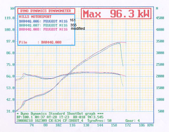

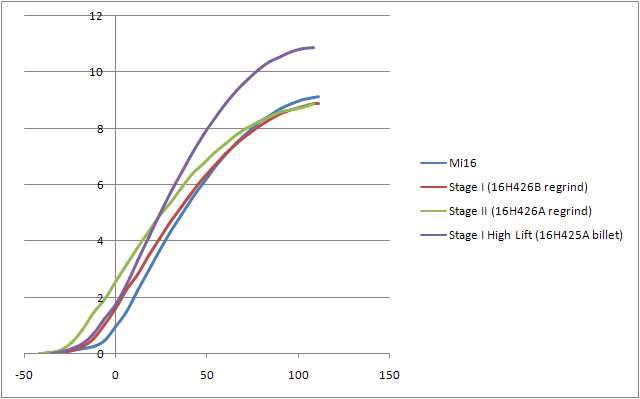

This result attached on a standard DFW gives the best indication of before/after with the St 1 grind. It's obviously better with a D6C, although I can't recall hearing of any results on otherwise standard engines. A decked D6C (10.8:1) and St1 cam gives around 95-96kW ATW. There's been plenty of modded D6C's (or equivalents) over here however, of similar spec to the one here. ie TB's and ST2 inlet. I'd say Craig's is at the high limit of the expected tolerance. ie 115kW at the wheels +/- 7kW would be the variation, as per what Sandy said. If someone said they were only getting 100kW ATW you'd ask questions, the same with 125kW ATW.

Good to see your happy craig it did seem to make good power after a bit of time being spent on it and deffo made a big diff with playing with the cam timing
as sandy says all figures from rolling roads can really be taking with a pinch of salt but we do keep ours well calibrated and well serviced

If you really wanted to be a nice person, you'd take the cam cover off and measure the lift @TDC for both cams and publish it here! It's a good idea to do it, even if you don't want to share. You've paid for the knowledge and if the engine blew up tomorrow, you'd have to do it all again.
