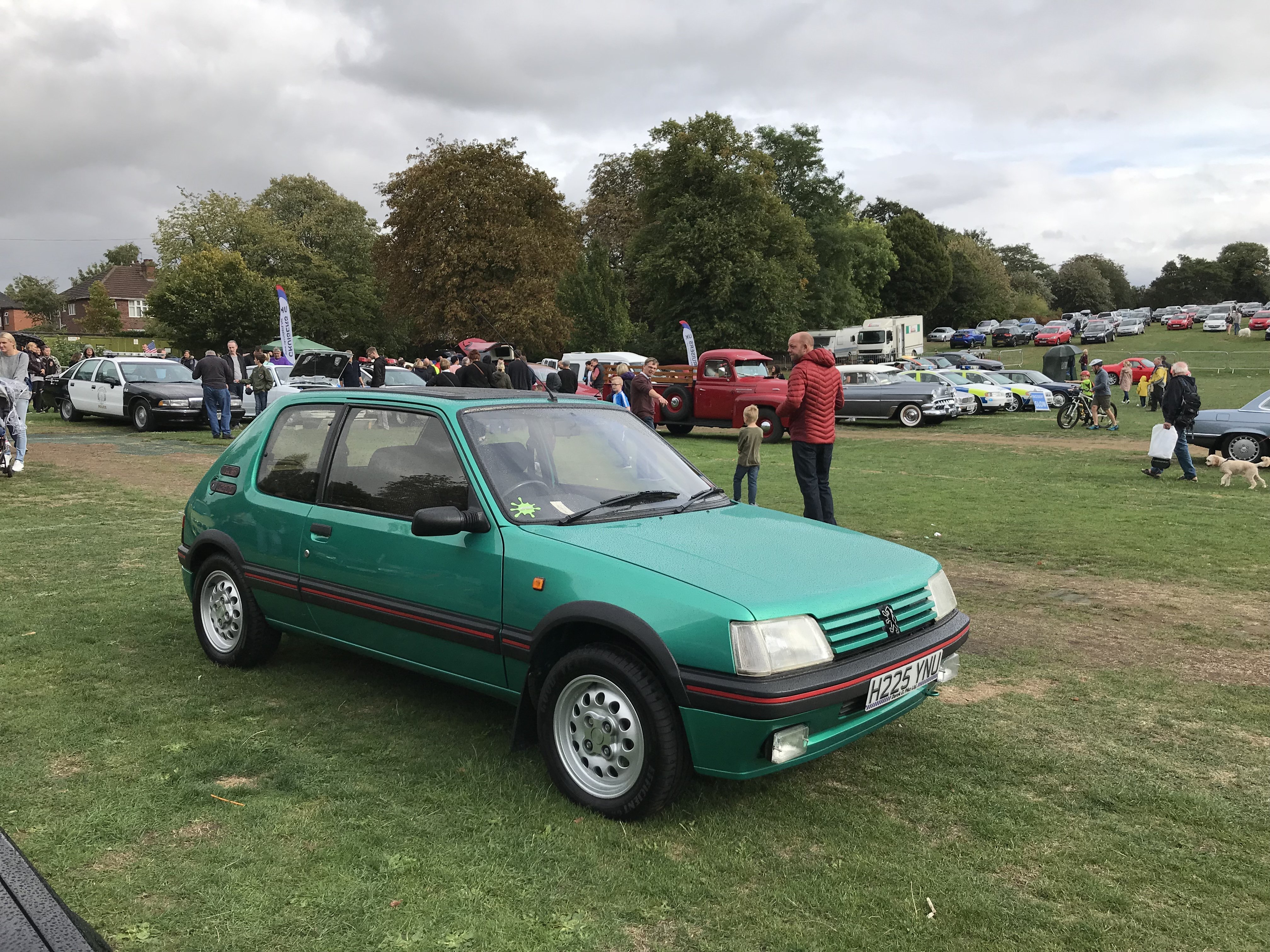

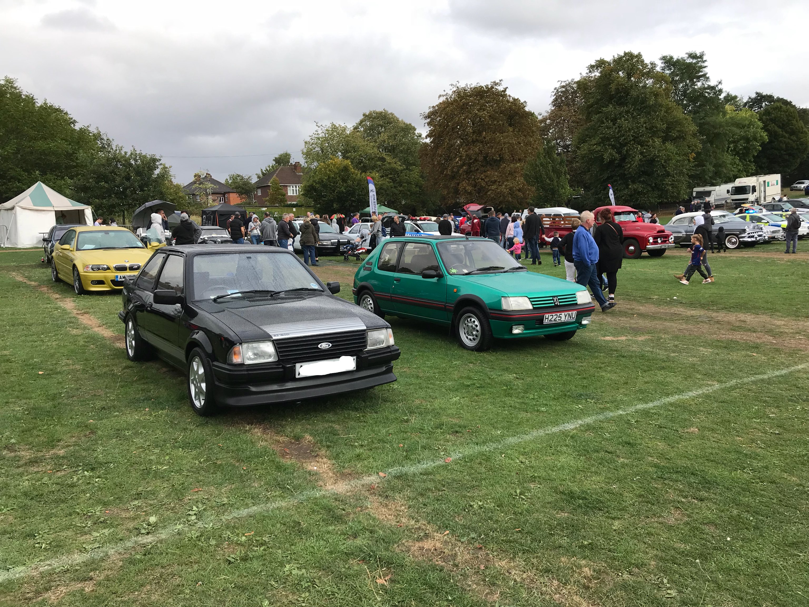

Just a couple of photos today, annual trip to the local show, a good mate of mine has owned his Escort for 22 years but it hadn’t been on the road for about 18 of those! He’d had a spurt on sorting it out, but the show gave him a reason to get it sorted and a deadline to do so. Great to see it out, and the 205 looked ok too!
