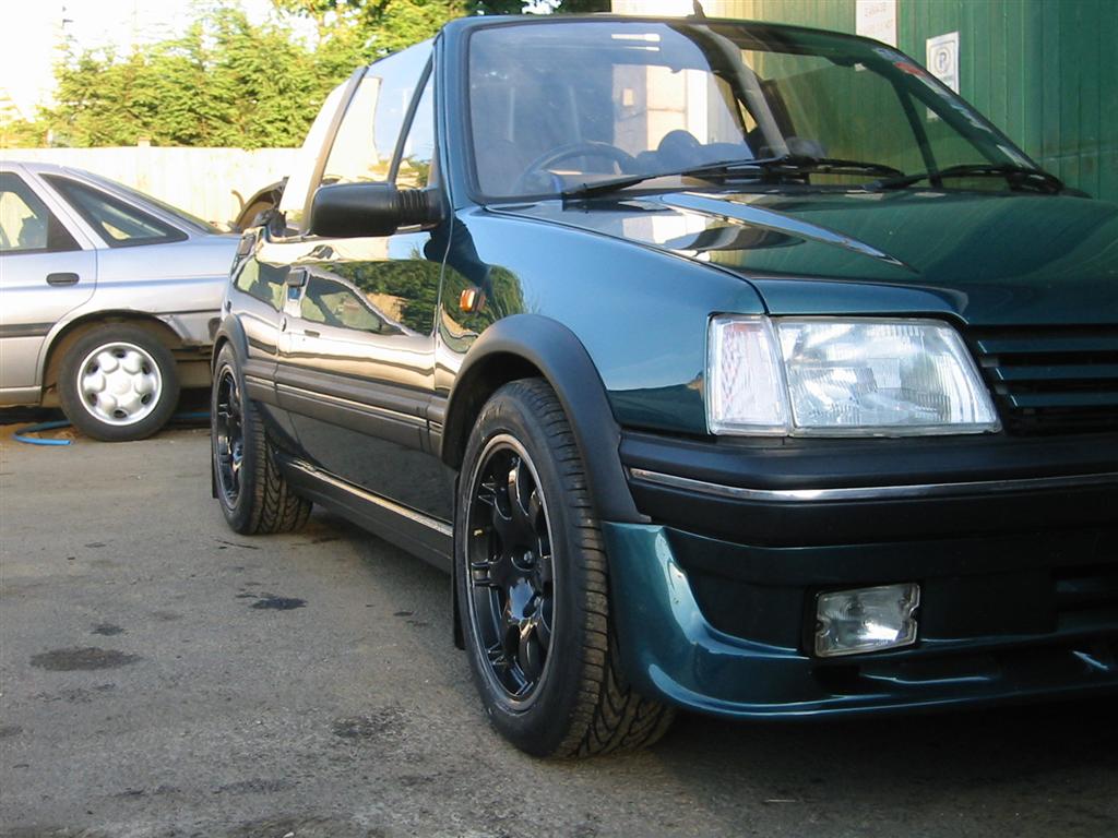

They don't stick out too bad at all, this is with 205 rear beam with ZX arms & drum brakes & 309 front running gear;

they look good Baz anyone got any more detailed pics showing the wheel on the front with steering straight. i am pretty sure the rears will fit but the fronts bother me a tad.

I don't think i have i'm afraid no, but they're really not bad, i appreciate some of those pics look like they stick out a mile, but they're basically in-line with the arch trim, plus bear in mind that's with slightly wider 309-running gear.

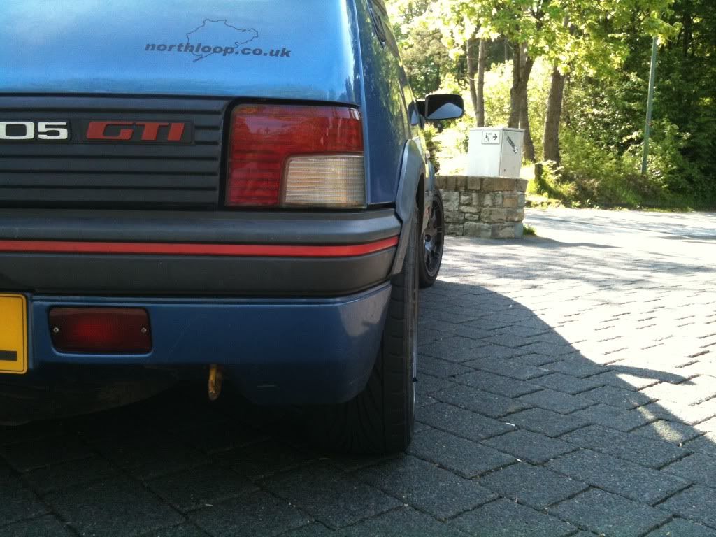

The best pic I have to hand, though I do have Gutmann arches which are slightly wider. I am on a 309 front set up with the 1.9 (309) hubs. If you were on 1.6 hubs then they would stick out some more over standard. I know the back catches on each side of the plastic arch as they are wider so little chance of running a lowered 309 set up at the rear on these wheels
