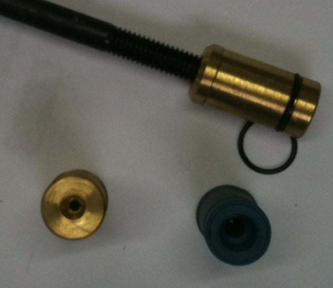

I'm sure sandy has said in the past that when the mi16 heads are fitted with solid lifters and a reducer in the oilway to limit the oil going into the head there are no issues with oil starvation - even with slicks

  On 5/25/2011 at 7:01 PM, rodionski said:
Could you please refer to that oil supply reducer to the head?
I am about to convert to solid lifter and would appreciate the hint. Thanks in advance.
Here's a pic. from my phone. Hopefully it's clear enough. The standard hole is approx. 3mm, mine is 1.5mm. I also tap the back M6 so it can be easily inserted/removed. I used brass as that was the closet stock size I had. Some would argue it's too heavy and should have used aluminium!
rodionski
Peter, thanks! Is this the part that should be inserted instead of the head oil filter?
I think i would need the measurements for this plug and comments on where and how to put it in.
Many thanks in advance!
There are two. They sit in the gallery behind each cam pulley. Undo the plugs with an allen key then you'll be able to extract the old ones. I wind an M6 bolt into them. It destroys them but how else do you know if the gallery is clean. For a thorough clean, once you've removed the non-return valves, use a length of 6mm rod to knock out the bungs on the dizzy end.
rodionski
Oh that's what they are. Then I know what you mean. Many thanks again!
