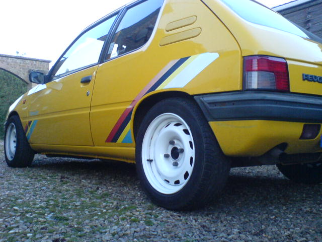

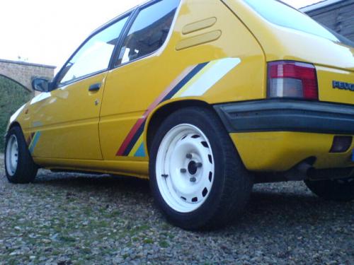

It will be on a rebuilt beam with standard dampers dropped the smallest amount (one spline!?) Anthony is building me one in January, can i get away without doing it? With what tryes?

185/55 should do the trick
Are they 5.5j or 6j though?

6j S2 ones

Hmmmm, not so. the 185/55's on my S2 wheels rub. Seemingly peugeot couldn't get two Rallyes out the same!!! ;) Will look into choppage, I have access to air line cutting tools so could do fairly tidy job of it.
