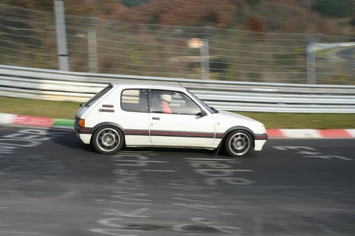

feb
How is my old car doing? :)
The good old glory days!
Edited by feb
cheesegrater
It's getting there slowly. It's in few pieces but I'm hopeful it'll be on the road this summer.
Anthony will no doubt laugh at that statement.
