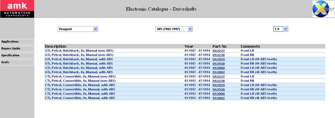

I have e-mailed Motaquip and this this the reply i received, does any one recognize any of these part number's ?
" Motaquip do have re-manufactured drive shafts in its range for this vehicle There are 6 different shafts that could be fitted DS3245 LH, DS3246 RH without ABS DS3003 LH, DS3004 RH with ABS 29 teeth DS3935 LH, DS3936 RH with ABS 48 teeth Motaquip do not re-manufacture these products themselves but I have checked with our supplier who has stock of all except for DS3004 Due to the age of the vehicle he will not be able to get further stock of this but can offer a "recon and return service" ie the worn part from the vehicle is sent to the re-manufacturer who refurbishes it and returns it to you This would normally take 7 to 10 working days Motaquip only supply to our Motor Factors customer base, a list of who can be found at www.motaquip.co.uk "

Edit - DS3003 & 4 are 'AMK' 1.9 205 shafts
DS3235 and DS3236 are 1.6 shafts. No idea what DS3935 are.
