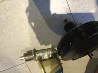

de Noir
Thanks Anthony. Is there any specific one which I'm looking for ? From which year and model ? Is it make a difference if it's with ABS or not ?
here:
servo unit (black) and brake fluid tank (white opaque) car of origin is 205GTI
aluminium thing belongs to non-ABS 406, part no 4601 G1 from Peugeot

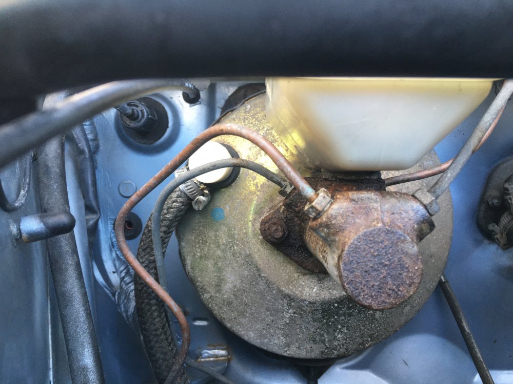

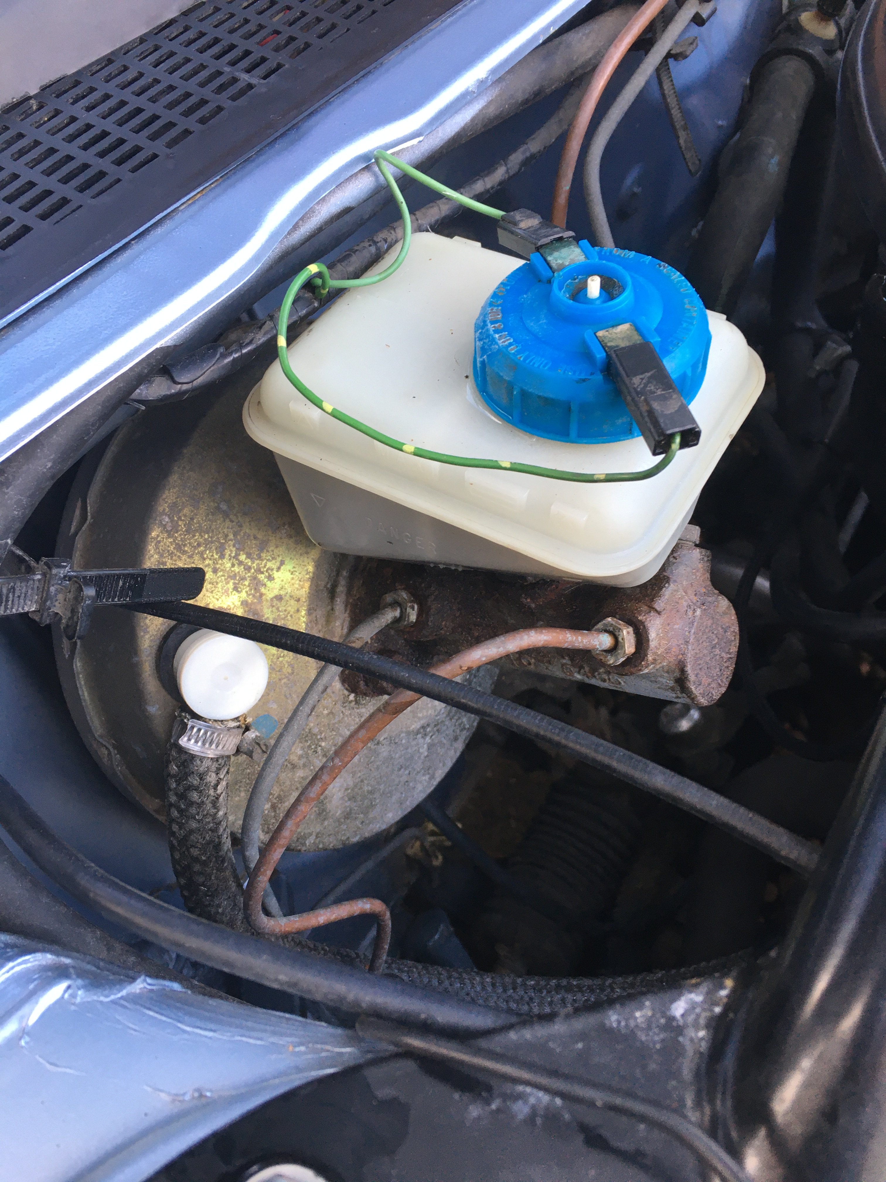

calmac
This is what is in car at present, mounting on master cylinder appears slightly different shape to 406 one, but holes may be in same location. Cylinder code ends in 0466 , can't make rest out but presume a 19mm one
