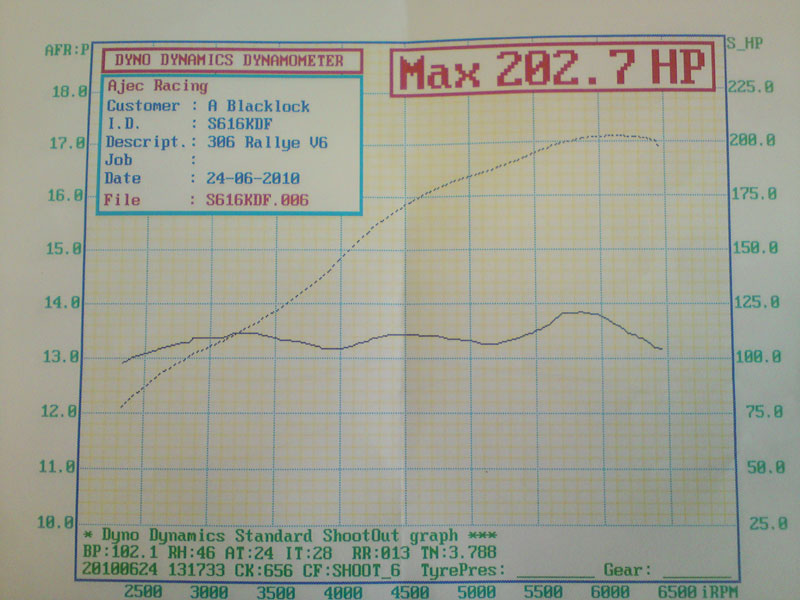

you dont want to go putting a d8 engine in a 205 the later d9 with the vvti is much better and the power deliver is much smother and more of a gradual build up rather than the earlyer one as it just thumps in at about 4k would cause a few problem i think due to a 205 being so much lighter
ade 4wd
In my experience the D8 V6 engine has a very smooth power delivery right through the revs even in a 205. The D9 is more powerful but has to be run on an after market ECU. Lots more cost.
Tesstuff
I have a D8 v6 in my 205 and it is nothing like you suggest, on what experiences do you base your opinion?
I concur, there is no 4k spike on the D8...
power/torue;
power/afr;
