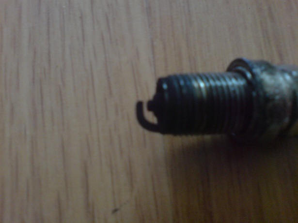

Ok took my 205 to my mates today and we hooked it up to his emissions machine and before any adjustments the CO was at over 2% :( also this is after I had retarded the timing as I had slightly advanced so god knows what CO would have been then :)
Anyway he first adjusted the idle screw abit which it started to climb down to about 1.8% still abit high so had a play with mixture screw on afm then went very low to aroun 0.68% so adjusted idle screw alittle and we eventually got it around 1% :lol: is 1% what a 1.9 gti should be set at?
It drives really smooth now can crawl along in 5th at a steady 30mph at around 1500rpm and is smooth barely any kangarooing :lol: do get abit of jerkeness on and of throttle but I think this is abit down to my engine mounts as they are alittle perished.
I will see how the fuel is now should be much better I hope B)
Here is a pic of my plugs that I took out other day too they were basically completely black in soot! so was overfueling obviously. :(
