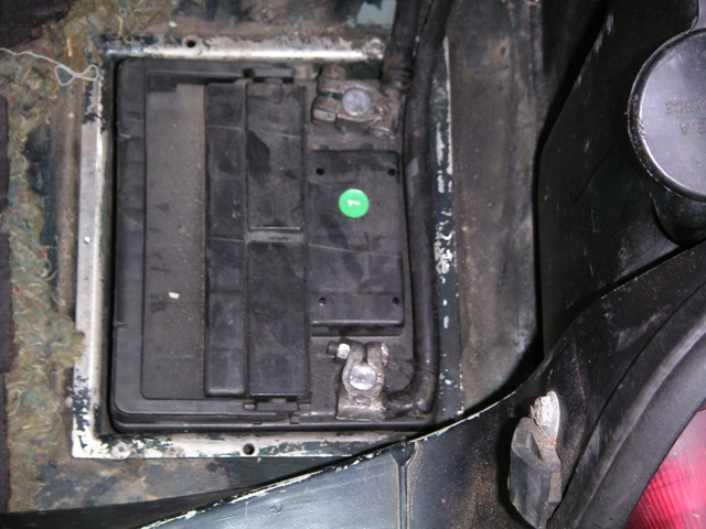

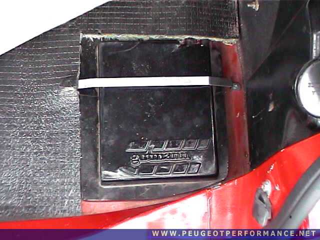

DaveW 6 Posted May 4, 2010 I found these pics, they are both in 205 gutmann's. Share this post Link to post Share on other sites
Paul_13 212 1 Cars Posted May 4, 2010 Interesting, might be worth doing! Share this post Link to post Share on other sites
