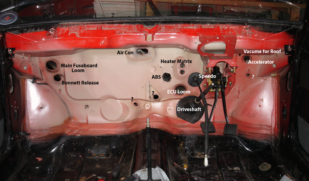

Yup thats the one! Looks like its in the same place as mine but mine's been done with a circle of 6mm drill holes and so the rubber grommet doesnt fit. I know my car is a reshell but clearly the shell was a non ABS and they've done a rush job on it. I'm going to take a photo of the bulkhead and we can name the holes as there are more on mine that aren't used but have no plugs either! When I was running the car I had bad engine fumes in the car, no surprise looking at the bulkhead. I'll do the photo in a bit, name what I can the post it and see what people think!

Ok heres the image of the bulkhead with what I think I know Labelled, can anyone name the three ?post-12223-1271922294_thumb.gif

thanks for you help guys, at least i know the ABS is in the right place. It would be cool to find out what the others are though. Also if anyone has rubber plugs for them as they're not used!
ade 4wd
The two small holes above the exhaust tunnel:-
The round one is for the heater drain tube if air con fitted, so normally has a grommet fitted.
The oval hole i think is for the lift up reverse cable on BE1 gearboxs.
