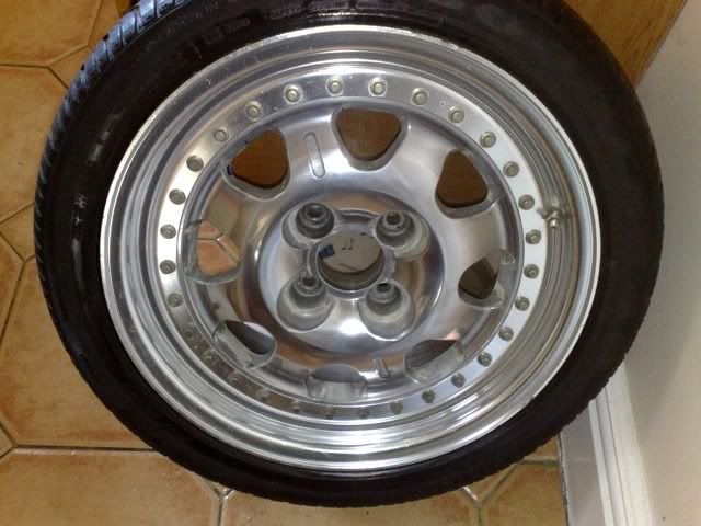

dino20vt 3 Posted March 21, 2010 Got some of these: http://i238.photobucket.com/albums/ff195/n...07/94f01872.jpg And need to dismantle them, from what I can work out I need a Female Torx Socket, but don't know what size and the bolts have at least 12 sides unlike the common 6. Any info appreciated. Cheers. Share this post Link to post Share on other sites
MerlinGTI 3 Posted March 21, 2010 Sounds like a 'multi spline' commonly used on VAG cars. Although I havent come accross a reverse multi spline myself. I cant really tell from the pic but how does a 12 point normal socket fit? Share this post Link to post Share on other sites
Ren 0 Posted March 21, 2010 (edited) If it's a multispline and you don't have any, I've got a set you can borrow if you want. Ren Edit: Didn't notice the female bit, haven't got a set of those. I've got a set of female torx though. Edited March 21, 2010 by Ren Share this post Link to post Share on other sites
welshpug 1,737 Posted March 21, 2010 probably "Ribe" bits. Share this post Link to post Share on other sites
MerlinGTI 3 Posted March 21, 2010 Ribes are 6 point IIRC http://en.wikipedia.org/wiki/Spline_drive Im thinking multi spline which wiki call 'Tripple square' or 'XZN'. The OP should be able to match them up using that wiki link though what ever they are Share this post Link to post Share on other sites
welshpug 1,737 Posted March 21, 2010 yep you're right on that, found illustrated quite well here http://www.guy-croft.com/viewtopic.php?f=13&t=1613 Share this post Link to post Share on other sites
