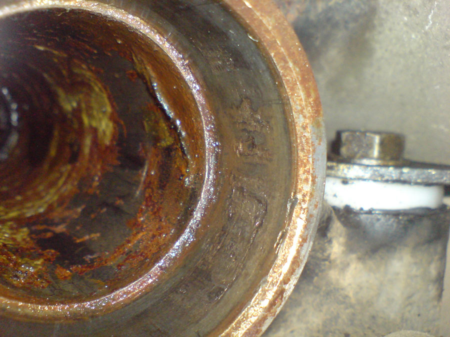

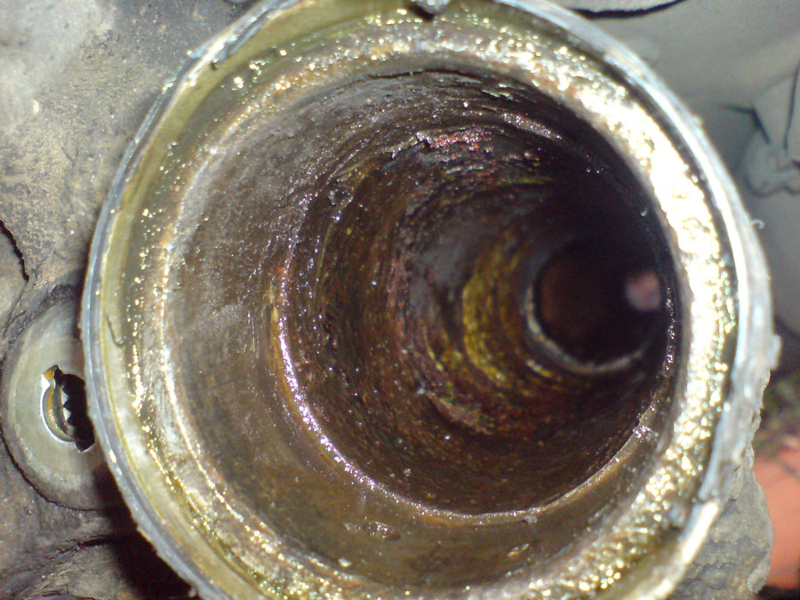

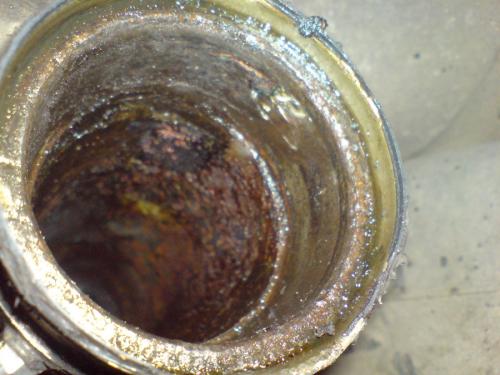

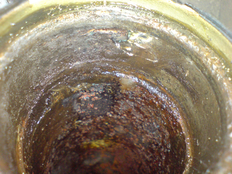

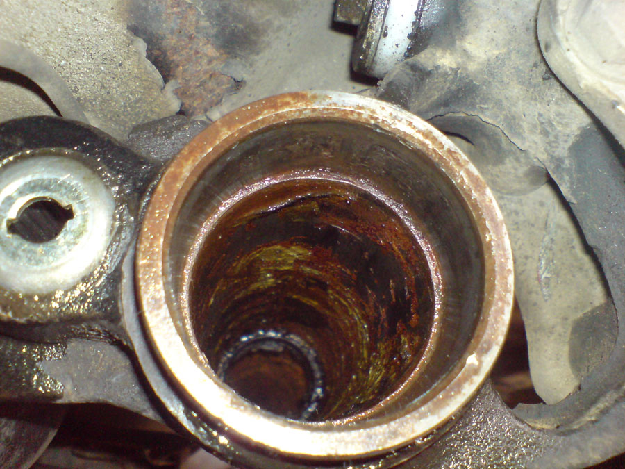

On another note (and to save starting another thread), I've just removed the outer bearings from the tube. They came away in two sections, the first being the cage and rollers, leaving the outer sleeve in the tube. I got the sleeve out but found that the inside of the tube that it sits on is rusty.... Does this mean the tube is scrap? I'll post some photos in a tic :mellow:

Capn. Pugwash
Here we go- it's the right hand side of the car, on the top face of the tube:
Another shot:
Capn. Pugwash
A couple more. The last two show the other side of the beam, it looks like the bearing has turned in the shaft.... :unsure:
Is it new tube time?
Have you been storing that tube in salt water? It is way past it. Find a good second hand one.
Don't be afraid of drilling into the bush. In fact, I'd be aiming at the centre of each. Drill 5mm, then tap M6 into each hole. Remove swarf of course.
MerlinGTI
I doesnt look too terminal in there? although its hard to tell with all the corrosion. You need to wang a wire brush drill attachment down there and give it a mega clean up before you decide. I welded an old (ford?) bonnet stay rod to the end of mine to give me enough length :(
