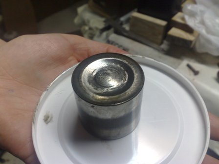

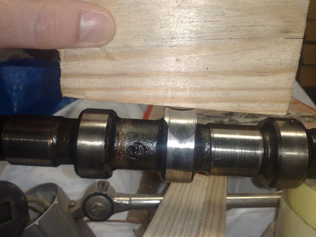

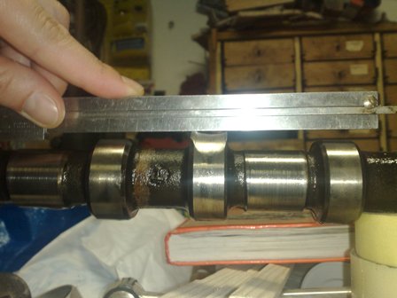

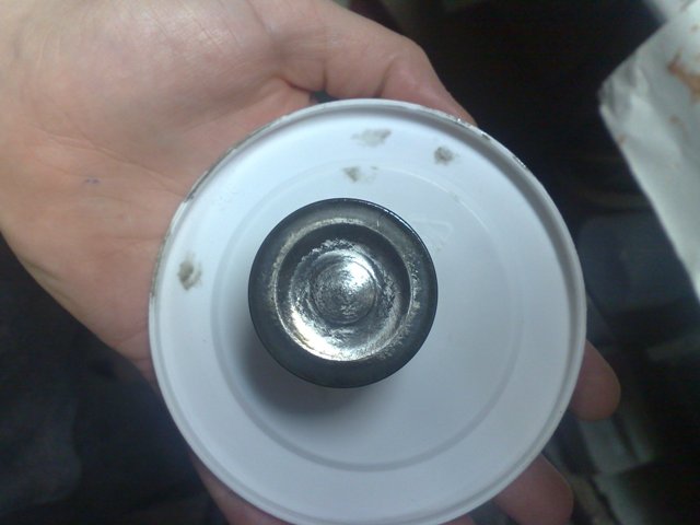

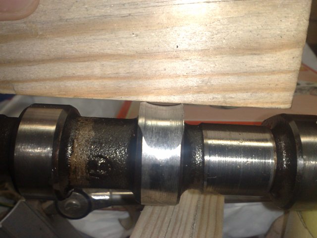

Damn. When I removed the camshaft cover, there was a big negative surprise waiting for me ;).
and this:
That happened few hundreds miles after headgasket job. I did't notice any damage during the head assembly and disassembly then. When i was driving i also didn't notice any oil pressure dropings (control panel gauge). maybe there was a little less oil pressure lastly, compared to before.
Why thappened this? Is this common problem? tha engine has 250k on the clock. I used total 5-40 oil. Any ideas,please.

Vz_ace
  Vz_ace said:
Damn. When I removed the camshaft cover, there was a big negative surprise waiting for me :unsure:.
and this:
thanks,
Vlado
no ideas? no one? I suspect an engine oil.
