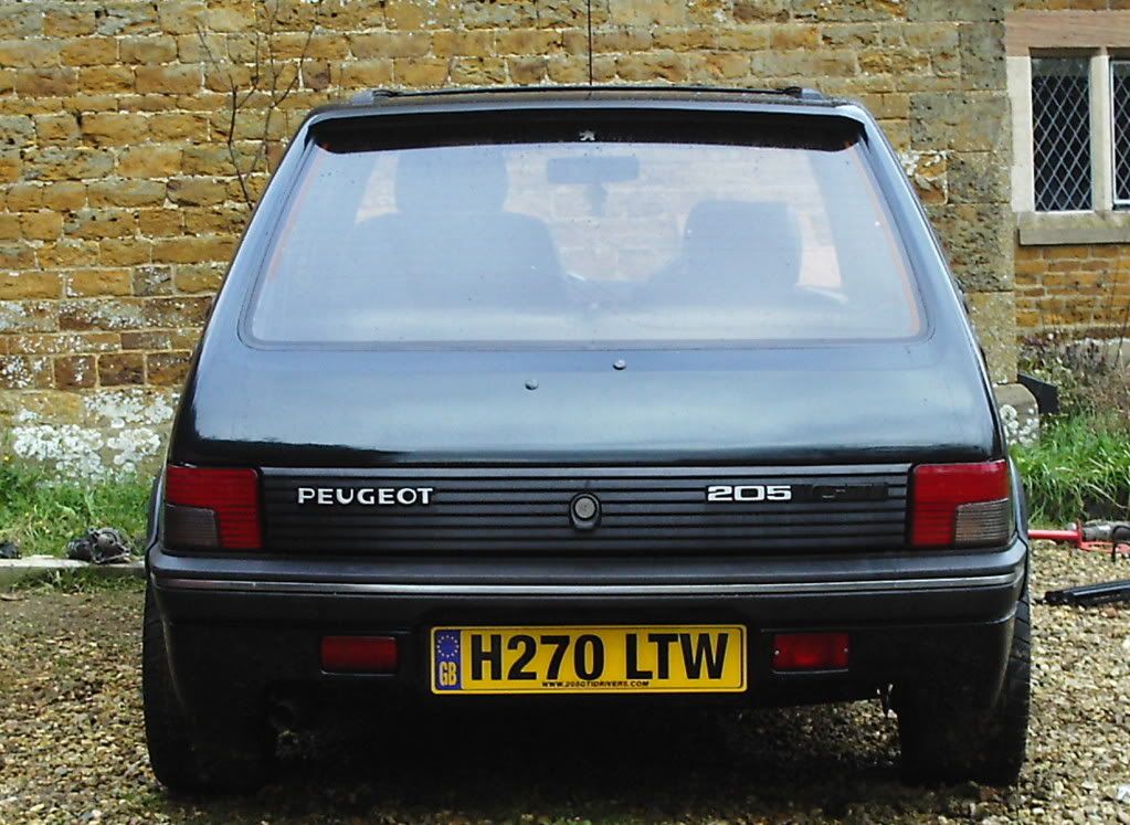

Have to disagree on the 309 beam front, imo its one of the best suspension upgrades, you do get the 20mm torsion bars and ARB which are the main benefits, as well as the wider track, giving improved stability and turn in. Personally never had any rubbing issues either, so unless you have rubbish shocks and/or its sat on its arse, its not really a problem!
All you need is a 309 tube, the rest can be sourced else where cheaply, so theres no need to spend hundreds on a standard 309 axle as some seem too. 24/22mm arb from a 306, torsion bars from a belingo/partner and arms from a zx/xsara/306 and you've got a great upgrade.
Also, from an asthetic point of view the 309 beam looks much more purposeful imo and suits the 205 much better, especially compared to a 1.6, which doesnt fill the arches atall.
vs
old pics but you get the idea!
I think its about 36mm overall extra rear track.
