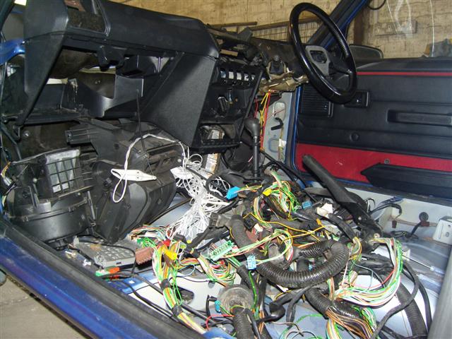

I've tried to search but with no luck, the car I have seems to have 2 looms for the same purpose (the car has been stripped before I got it), both have the connection for the ECU but one seems to have more connectors etc than the other. But I can just about make out the part no listed on each.
The car is a 91 car with ABS and PAS.
Any help would be appreciated. Oh and any pointers to mating up the various plugs etc may help me, as I can't make head nor tail of a wiring diagram?

well I think I've sussed it.
Laid both looms out side by side. One had many more connectors than the other, so started to id the injector leads. Next was the AFM connector, then the coil connector, now one loom had this (the one with fewer connectors) but the other loom didn't have this. So I've reinstalled the one that fixes to the coil.
So I'll get a pic of this extra loom, but also what is puzzling is I have an extra AFM with airbox mounted directly to it? Pics to follow of these so someone hopefully can pinpoint what they are. But for now a pic of the car as I received it, loads of wires?? One big jigsaw puzzle.
miamichris
^^ to me, that looks quite terrifying :wacko: good luck!
MrG
to me , it IS bloody terrifying. but I'm tackling it a few hours at a time before frustration kicks in!
