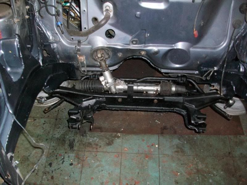

Hi would a PAS rack from the peugeot 306 fit the 205 subframe ?? and works on the 205 ??? thanks
jimbean
it sure does...
this is a gti 6 rack
it just needs the track rods off the 205 fitting

What type of end sterrimg colum did you use to fit the tip on the 306 rack ???
