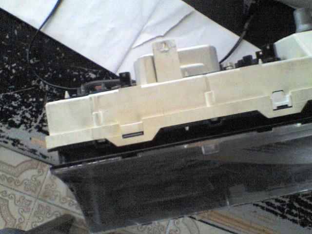

Ok, I've removed the clocks from the dash, but how do I separate the plastic backing with the bulbs on it from the black part of the housing? I see some plastic tabs around the sides of the housing. Do i just prise these back, or are there screws I need to remove first?
I hate the prospect of having to tug at Peugeot plastic :(
humanz

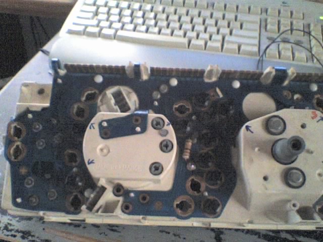

Well, managed to swap over the clocks. First, the tabs have to be released. Once the clear plastic is off, several 5mm bolts are revealed. I loosened the two retaining the speedo and loosened the two 7mm bolts at the back of the speedo. Then I pushed the speedo from the back thru the front of the housing. Refitting was the reversal of removal. I'll test it to see if all works well in the morning.

looking at humanz' pictures - what do i need to fix or replace here?
it's a ph2 Veglia unit, LHD and metric, if this does matter.
