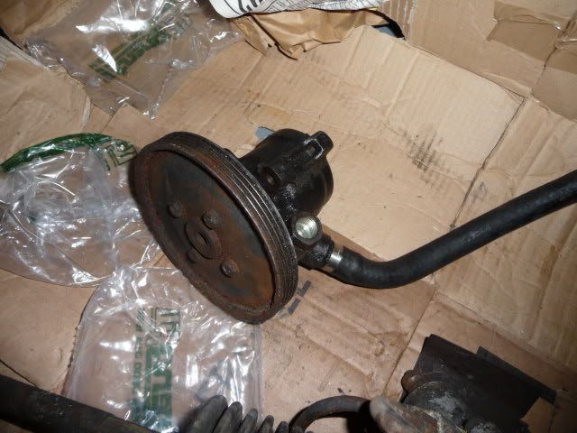

Kit.jpg pas kit
Pump.jpg pump for xu

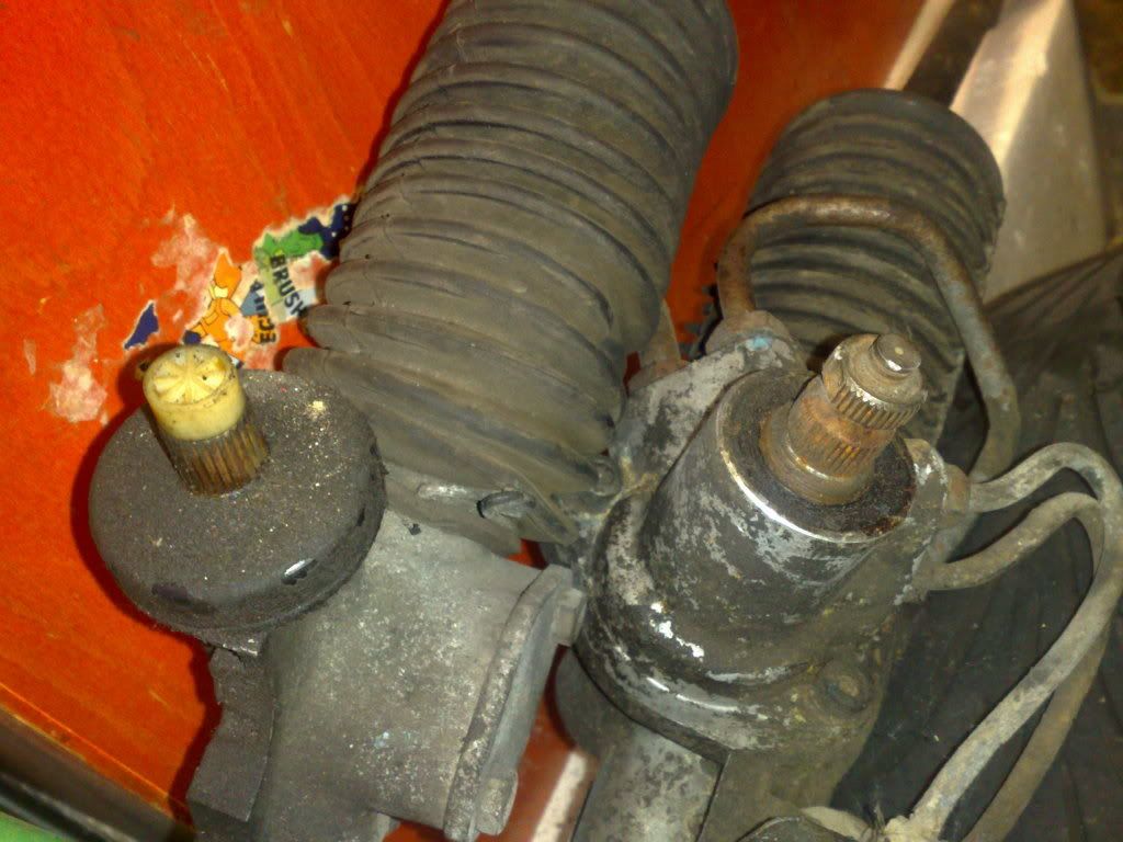

Ive got round todoing the rest of the conversion, but stumbled on the fitting of the rack. The splines here are different sizes. What do I need to convert to make this fit? Does anyone have the part? I heard the sline size and shape was changed about 4 times. Oh and where the hell does this high pressure hose fit?
j_turnell
You need a shorter uj to fiit on the pas rack, the high pressure hose iirc runs from the pump, under the inlet, metal pipe, along side the thermostat and down to the rack.

Went to Peugeot yesterday about the joint change and they didnt seem to know which one i needed. I took the old joint to them and showed them but they said without the rack they couldnt identify which joint I needed. They printed out some pics and apparently the splined joints are different lengths PAS and non-PAS. I dont know if it was the top joint or the bottom and neither did the parts guy. One is 45mm and the other is 55mm. Can anyone identify my rack (in above pics) so I know which one to buy? I think one was £70 from pug and the other was £135. Ive got the engine out at the mo for a rebuild and I want to get this sorted before it all goes back in!!!! Help!!! I can post more pics if necessary, unless anyone knows if there is some ident on the rack itself. cheers
j_turnell
As i mentioned above you need the shorter uj, i can only imagine they do two lengths, pas and non pas so i guess you'd need the 45mm?? No point in spending that amount at Pug though, just get a second hand one!!
