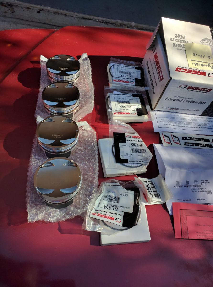

However (depening on valve pockets of course) I have also found the Wiseco K669M87AP for Mitsu 4G63 / 4G64 engine.
They are 28.875mm CH and 22mm pin, 87mm bore. Giving 0.125mm deck clearance.
However 12.5cc dish so compression is down to 10.2:1 with 1.3mm HG.
The Honda pistons are probably a safer bet regarding valve pockets, even though it looks like the Mitsu ones probably will be OK too.

The Wiseco pistons for 4G63 I have in stock so I can measure if you need some other info.

Wiseco 4g63 87mm postons with 35mm comp height, available with dish -4,5 -10 -14 -17 -22.
-10 dish would give about 11:1 comp ratio? And piston flush with deck? -14 dish about the same as standard 10,4:1?
