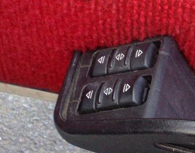

pete1986 2 Posted January 2, 2009 I have renault 19 window switches in mine. Didnt have to swap anything apart from the switches. Although i had to trim a bit of plastic off so that the plugs would fit in the back. Heres a photo to show you what they are like Share this post Link to post Share on other sites
