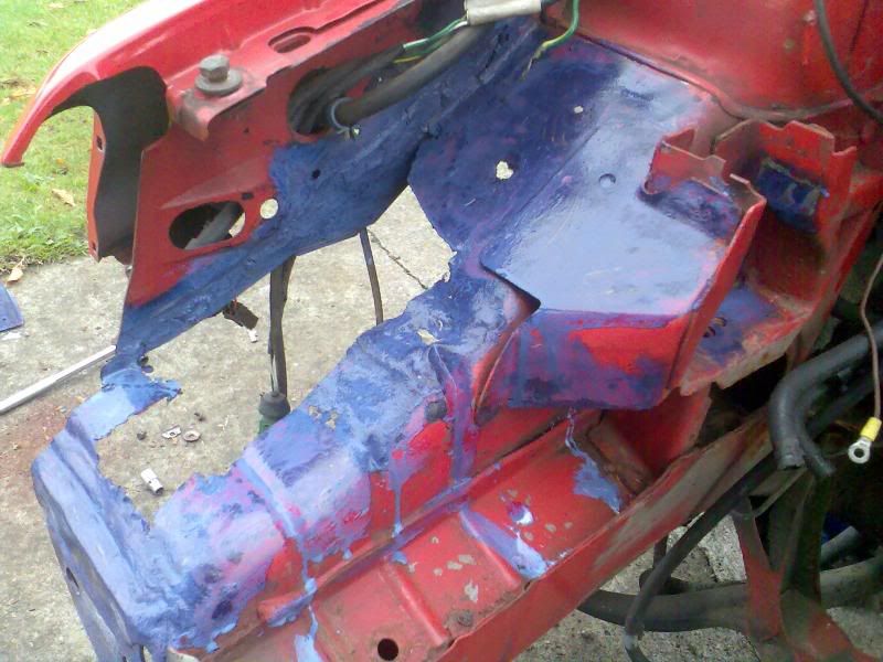

Fox 3 Posted August 28, 2008 It went on my ph1 rallye there. Share this post Link to post Share on other sites

dirtdog 4 Posted August 28, 2008 i wouldnt have thought so. the rust on the phase 1rallye is worse than on your ph2. ou should be able to do it without taking hardly anything off Share this post Link to post Share on other sites
Fox 3 Posted August 28, 2008 Oh God, this won't be an engine out job will it?!? Nah, I was just swapping the engine when I found it. Taking the slam panel off makes it loads easier to get it though. Cut it out, make a template, weld it in, bobs your uncle! The hole for the washer jet bottle was made by drilling loads of holes, then a hammer and chisel to cut out the hole. Not the best job I've ever done but it did the job and is still rust free! Share this post Link to post Share on other sites
