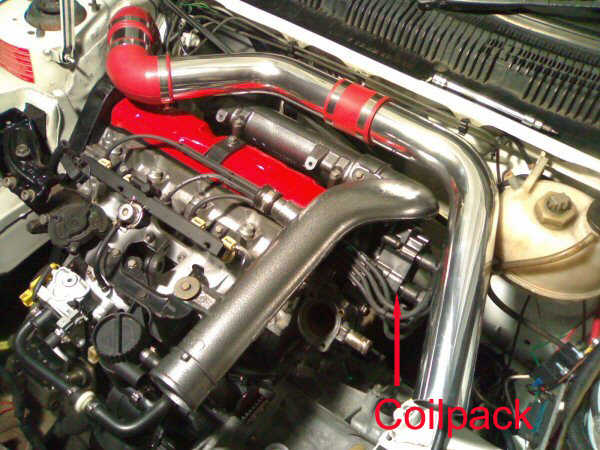

Mikey G
You need to find the 2 wires that stretch across from the coilpack to the ignition amplifier, they should be a blue colour. These are the coil negatives that get switched to ground by the ignition amplifier and thats where 2 wires need to go.

Mikey G
The coil pack is on the end of the head just under the main boost pipe in that pic, and the ignition amp is in the lower right hand side of the picture bolted against the inner wheelarch.
I should know i did the wiring on that car lol

Ah Ha. i see. I've just had a look at mine and the amps in the same place as yours and disco stu's. so its the coil pack that has a 5 pin plug underneath the leads, which goes to the amp which also has 5 pins. i genuinley didnt have a clue of what i was looking for, there are so many wires going to strange looking components. Im more of a rotor arm and dizzy home mechanic.

The ignition amp can't be seen in that picture but it looks exactly the same as the one originally fitted to the 8v engine on jetronic & could even be in the same mounting point. (drivers inner wing on late phase1.5 / 2's).

You can see it, its right on the K of 'Coilpack' ;)

So it is, depending on the age of your car it might not be there though.
My H reg Gti had it on the offside inner wing so if you have an inlet mounted coil it could be there.

Cheers for all of your replies guy's. Thanks to you all i finally know what a coilpack is. (its not a dizzy cap <_< ) My ignition amp is on the n/s inner wing. The cars an '89' F. So i put the XU10s amp there. Basicly i tried to put the 406 engine in as it was in the donor give or take a few alterations. Im happy now i know where to connect the wires.
