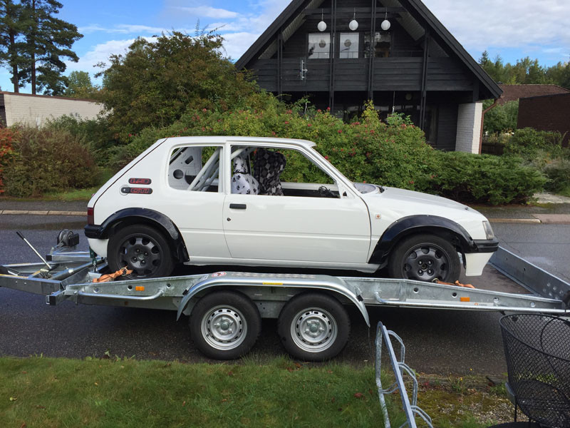

Picture from the touchdown the other day.
johniban
Are them wide arches really necessary ? seems to ruin the look of it IMO
SwedishBob
The old arches didn't work with my wheels so I had to get wider. Maybe not this wide but the picture I have in my head of the finalresult looks cool so I hope the reality will do it to. :wacko:​
It's temporary wheels on the picture,.

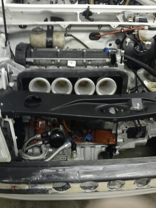

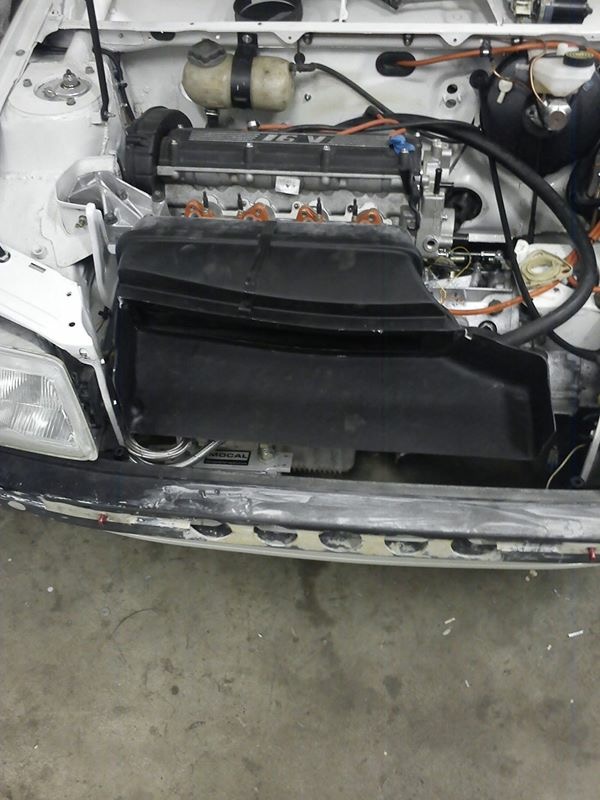

The car was sent to FR Autosport this Saturday, It will return with new fuel system, TB's, Sybele ECU, Race display, etc...
SwedishBob
Some progress. But the TB´s are quite big so It won't work with standard engine mounts. :angry: Plan B in the making.

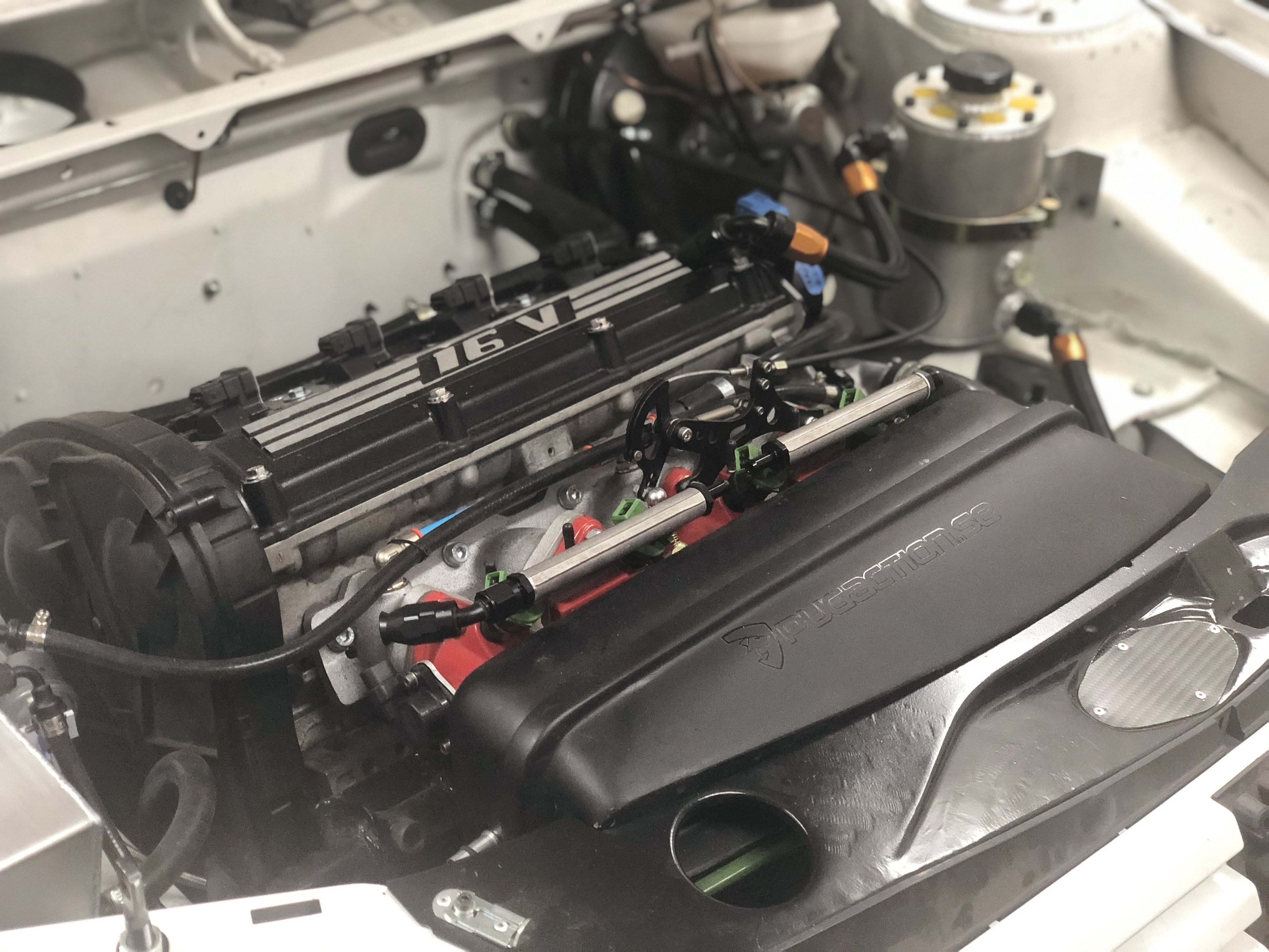

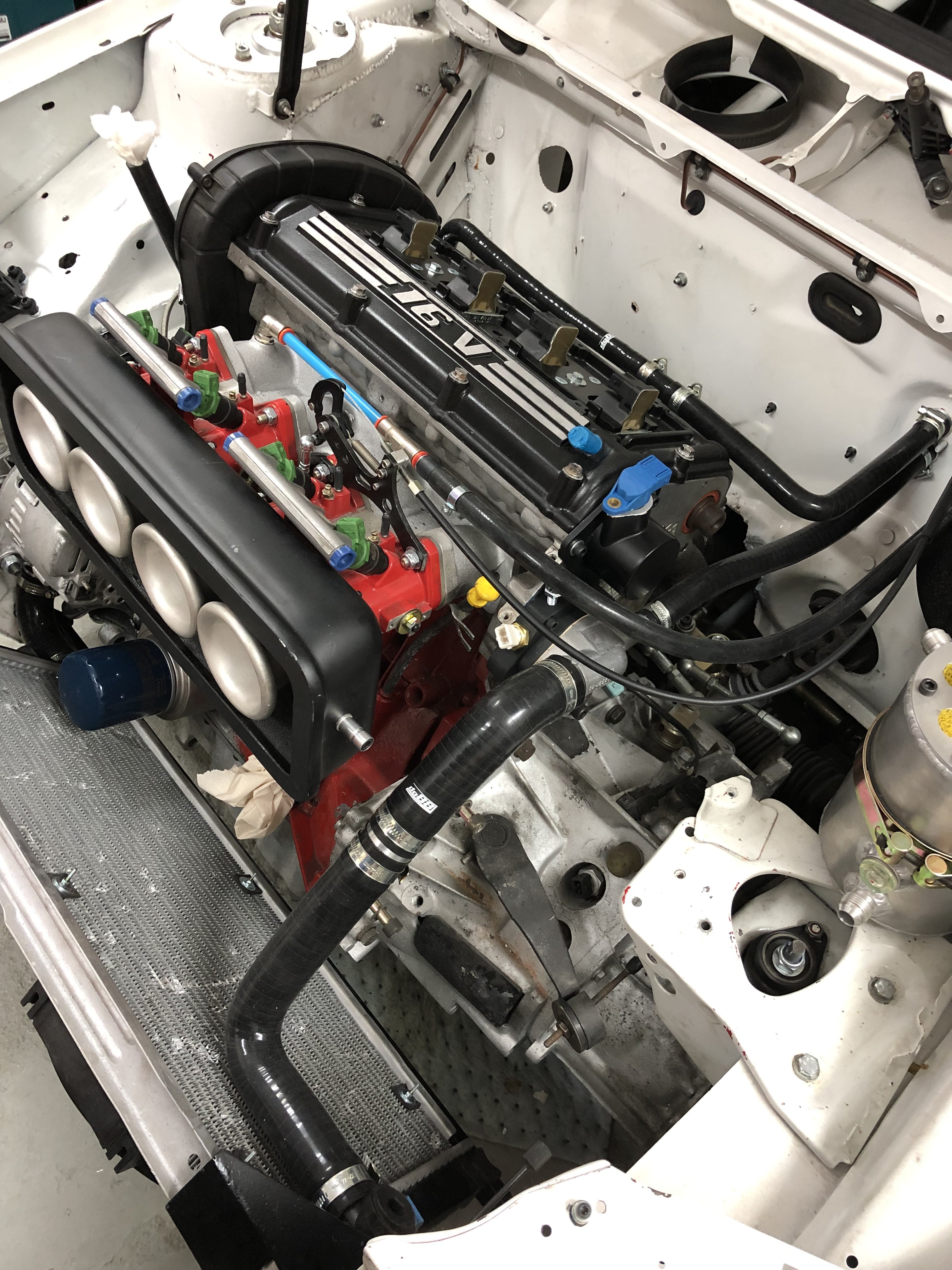

Start to look more and more like a complete engine bay.
Waiting on some AN fittings and then will the coolingsystem be complete.
Next step after that is to send the car away to get the harness for the engine done and installed.
