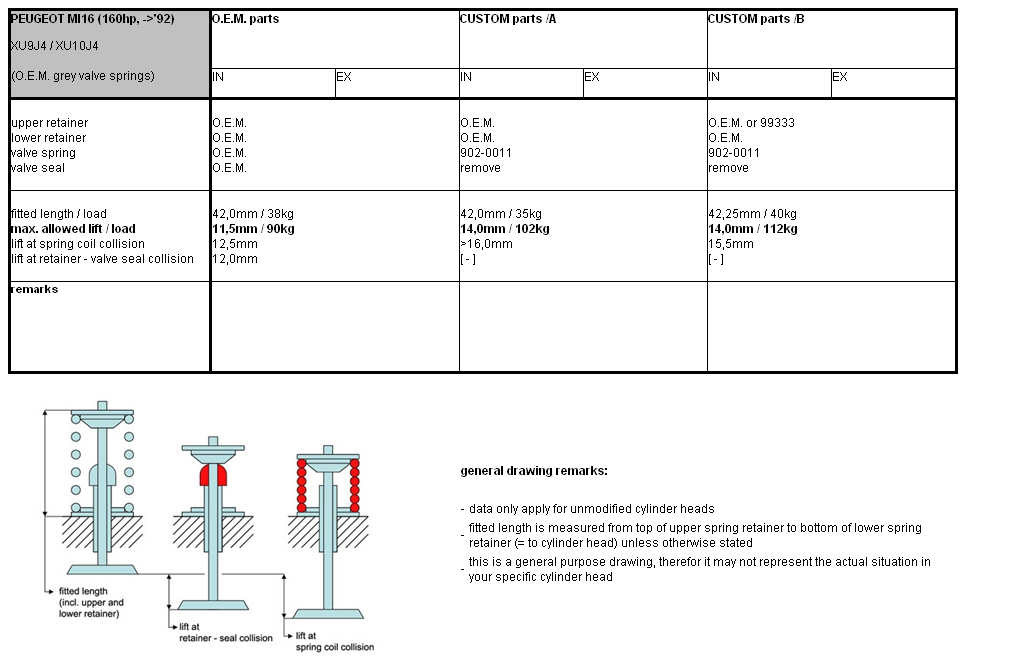

Super Josh 4 Posted October 6, 2006 Pistons crown height is lower to give the reduced compression. Valve springs are different too, at least according to the Catcam website. As maximum valve lift is quoted as lower, limiting the particular Catcam that can be fitted. Don't know if the Cams and pulleys are different too. Josh Share this post Link to post Share on other sites

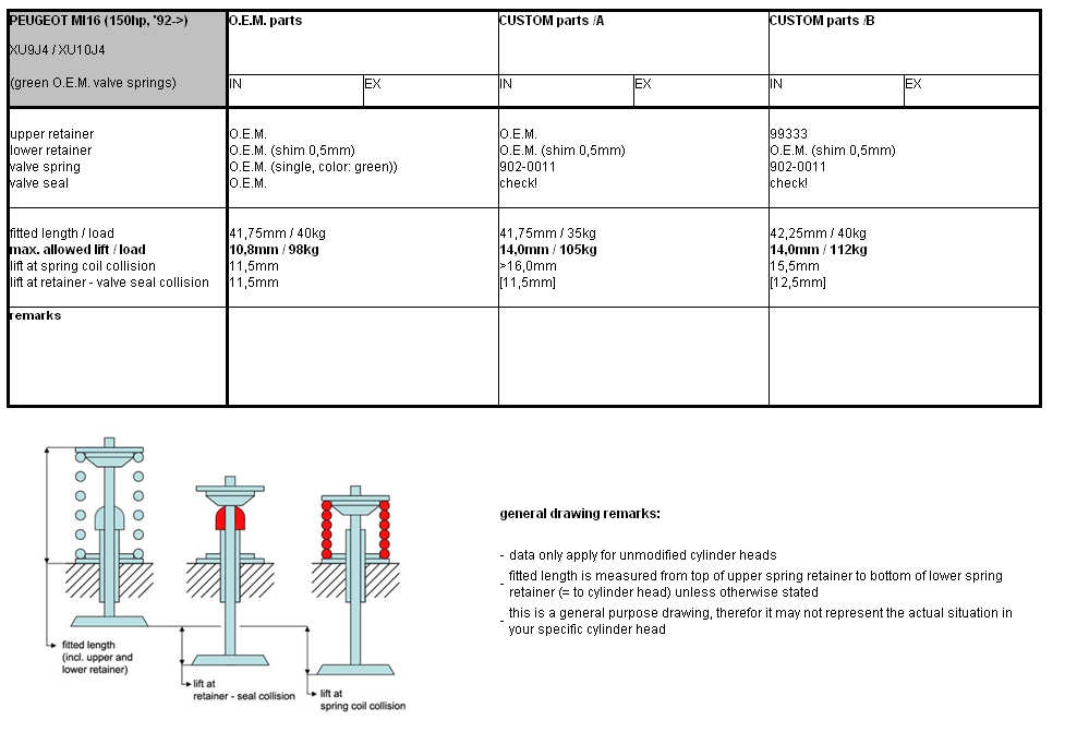

Super Josh 4 Posted October 7, 2006 petert said: The cams and valve springs are definitely identical. So Peter, how do you explain the info on the Catcams website? They talk about 'Grey' and 'Green' O.E. springs. Here's the info.... XU9J4 XU9J4Z Notice the 'Fitted Length / Load' and 'Max. allowed lift / load' are different for each spring type. Now obviously, this won't be a problem when using the standars cams. But could be a problem when using aftermarket items. Cheers, Josh Share this post Link to post Share on other sites

petert 617 Posted October 7, 2006 Super Josh said: So Peter, how do you explain the info on the Catcams website? They're wrong. I've also measured XU10J4 springs and they're identical to XU9J4Z as well. Share this post Link to post Share on other sites
