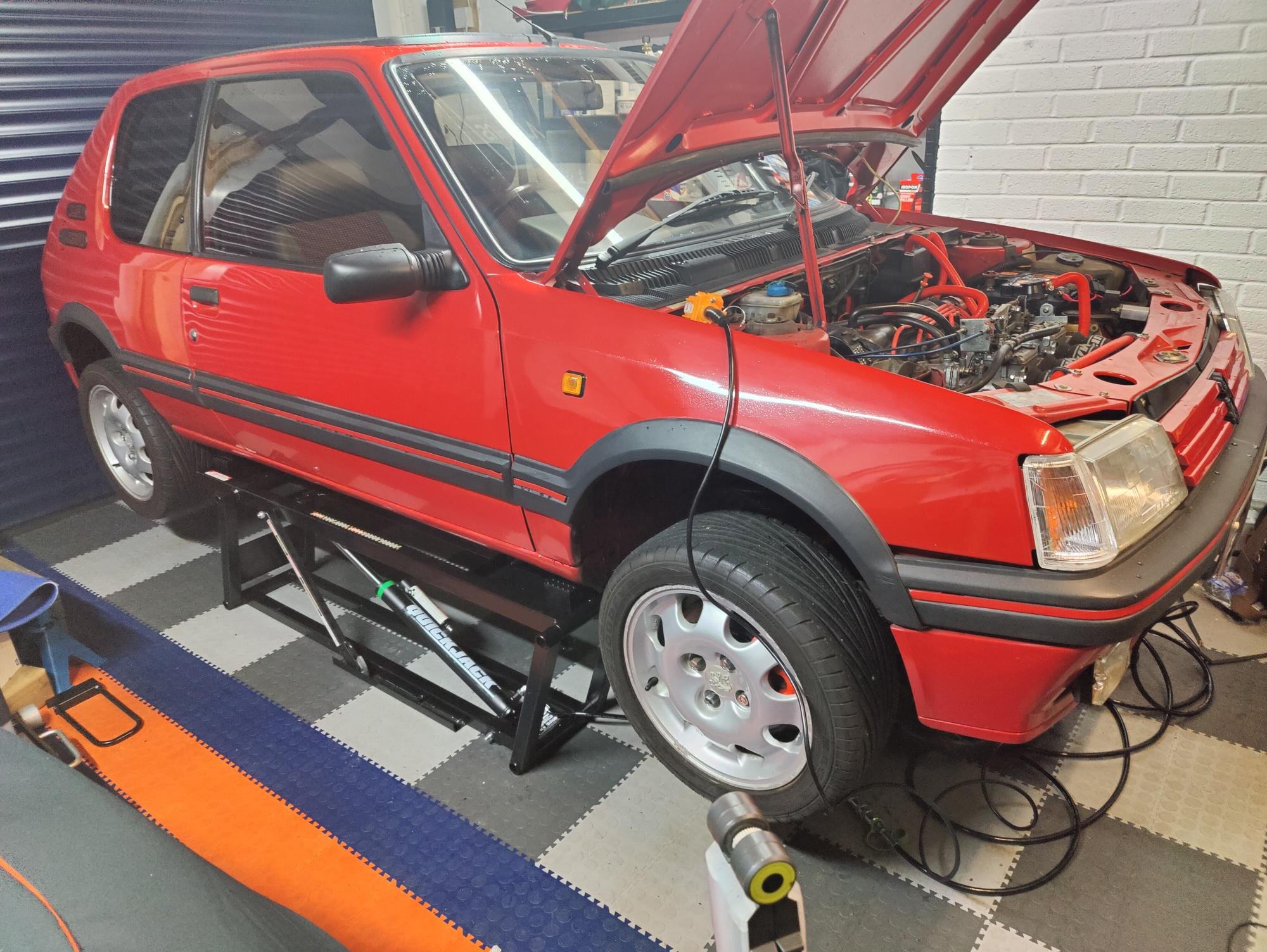

Quags 0 Posted December 14, 2022 Hi, Sorry for the long winded question, but I have noticed an inner boot on the OS driveshaft has split. Now, I have a 1.6-1.9 skip brown conversion with an Mi16 Gearbox and GTI-6 front discs. What on earth driveshafts will I have for this combo? I don't know yet if they'll all need replacing, or if I need to replace both shafts etc I just need to know where to start looking. Unfortunately I have no info on what the shafts are from the previous owner. I have just purchased a quickjack though, will make life much easier! Share this post Link to post Share on other sites
